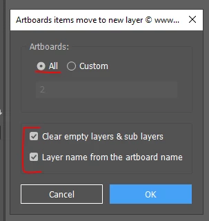

Hi all,
Could anyone please have a look on the below script and help me to get a version without the fancy dialog window? I tried to do it myself, but no luck 😞 I intent to merge it with another script, so basically, I just need the code to move 'All' items into 'Layer name from the artboard name' and 'clear empty layers & sub layers'. That's it! Any help would be greatly appreciated.

Correct answer Sergey Osokin
  Program version: Adobe Illustrator CS5+
  Author: Alexander Ladygin, email: i@ladygin.pro
  Copyright (c) 2018
  www.ladyginpro.ru
  19-June-2024 Silent version (without UI)
  https://community.adobe.com/t5/illustrator-discussions/help-to-get-a-script-without-dialog-window/td-p/14689770

function __artboardItemsMoveToNewLayer() {
  var arts = activeDocument.artboards;
  var l = arts.length;
  selection = null;
  function __move(items, __index) {
    var layer = activeDocument.layers.add();
    var j = items.length;
    layer.name = arts[__index].name;
    if (j > 0)
      while (j--) {
        items[j].moveToBeginning(layer);
  for (var i = 0; i < l; i++) {
    activeDocument.artboards.setActiveArtboardIndex(i);
    activeDocument.selectObjectsOnActiveArtboard();
    __move(selection, i);
    selection = null;
function main() {
  if (!app.documents.length) {
    return;
  __artboardItemsMoveToNewLayer();
  [activeDocument].emptyLayers().remove();
  selection = null;
main();
June 19, 2024
That's exactly what I need 🙂 Thanks so much @Sergey Osokin !
