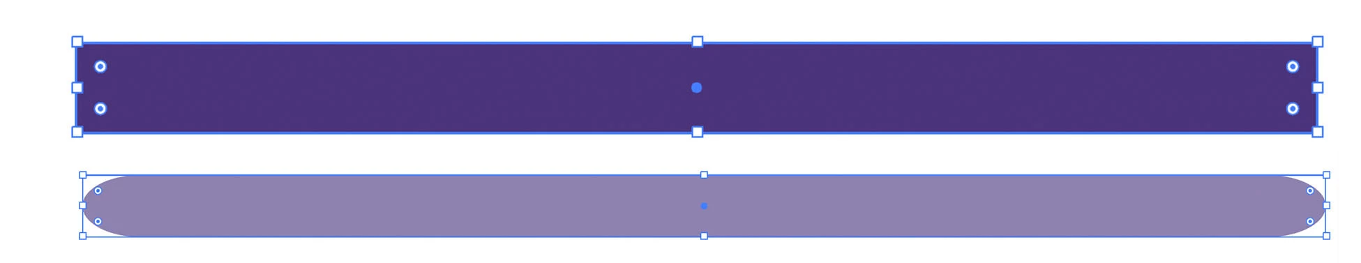

Can someone help me understand why the corner widgets work differently on these two rectangles.
The top dark purple rectangle is the one that I just made. When I move the widgets the corners either change into a semi-circle or back into hard edges. I’m trying to copy the light purple bottom rectangle to understand how it’s been made and how it works.
The corner widgets do the same thing but create more curve and are positioned in a different place.
Any help will be much appreciated. I’m very new to this!

    Hi, and welcome! The widgets aren't really behaving differently — they're showing each shape's own corner radius, which is stored with the shape.
    A couple of things explain what you're seeing:
    • The widget sits along the edge at a distance from the corner equal to the current radius. So if the light purple rectangle already has a larger radius set, its widgets start further from the corners than yours, and dragging them produces a bigger curve.
    • A corner radius can't be larger than half of the rectangle's shorter side. Your rectangles are very shallow, so on your new one you reach that maximum very quickly — the two corners on each short end meet and the end becomes a semi-circle. Dragging back to zero gives you the hard edge again, which is why it feels like all-or-nothing.
    To copy the light purple one exactly, don't drag by eye: select it, double-click one of its corner widgets (or open Window > Transform) and note the Corner Radii value, then select your rectangle and type in the same value. Also check the corner type matches — Alt-click (Windows) / Option-click (macOS) a widget cycles between Round, Inverted Round and Chamfer.

    Bex5C51Author
    Oct 8, 2026 1:24 PM UTC
    Thanks so much for taking the time write such a helpful reply. Your instructions are super easy to understand and I can get back to my practice now.
    Thank you so much!
