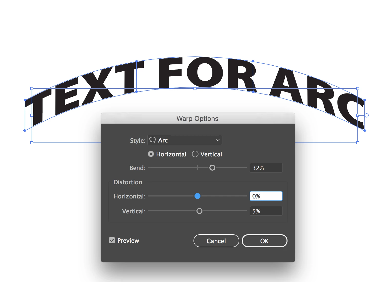

Arc with a bit of vertical distortion will get your close. Since the bend number is smaller, the distortion number is smaller, too.

SJRiegelCorrect answer
October 3, 2017

A small adjustment to the vertical distortion should bring your text back in line. (in this case, 5% did it)
