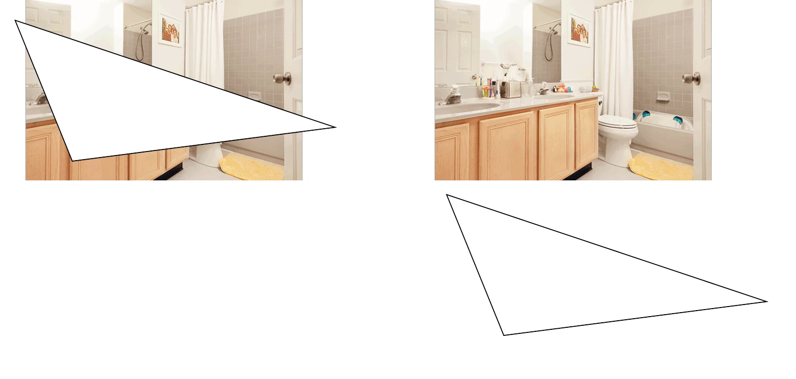

Hiya,
I am trying to put an image in to a simple triangle shape. I understood that all I needed to do was highlight only the two elements and go to Object>Clipping Mask>Make - now this appears to work in the layers panel with the two objects merged in to one group and the image disappears from my workspace; however, in the design the triangle just turns white.
Can anyone help me with this!?
TIA
Correct answer Ton Frederiks
Maybe the image is outside the clipping mask.
Try to select the image in the layers panel and move it into the visible area of the clipping mask.

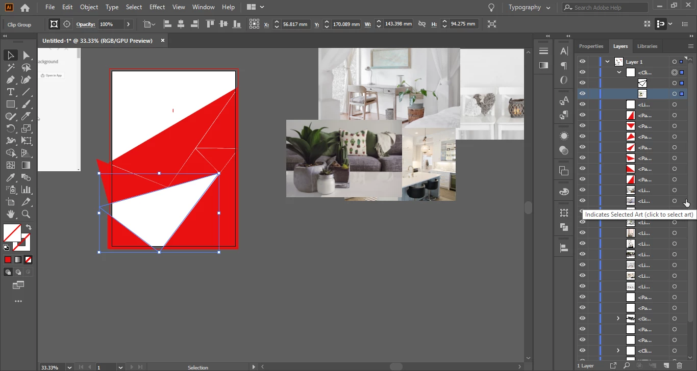

here is some info:

January 8, 2020
Hi Ton,
I actually thought it might be that but don't know how to move the image once it's in there? Sorry I'm a novice! Any chance you could explain?
January 8, 2020
Nevermind! I've done it, thank you!!!
January 8, 2020
Can you show a Before screenshot? Is the photo you are trying to clip located inside the area described by the triangle?
