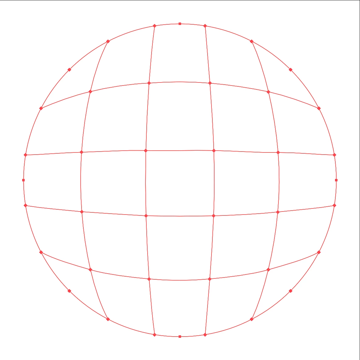

Im basically trying to create a circle with a grid inside like the images below.
(P.S. I used the gradient mesh to create this effect)
I basically just need to know if there is a way I can give the lines in the circle a fill so that it gives the effect of a circle with solid gridding inside it.

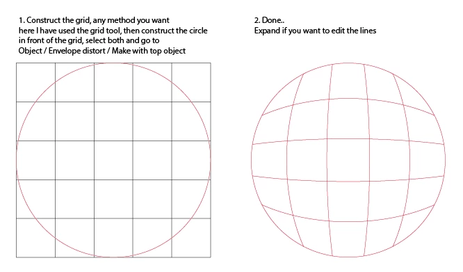

Here is another way

Here is another way
October 30, 2018
Thank you!
