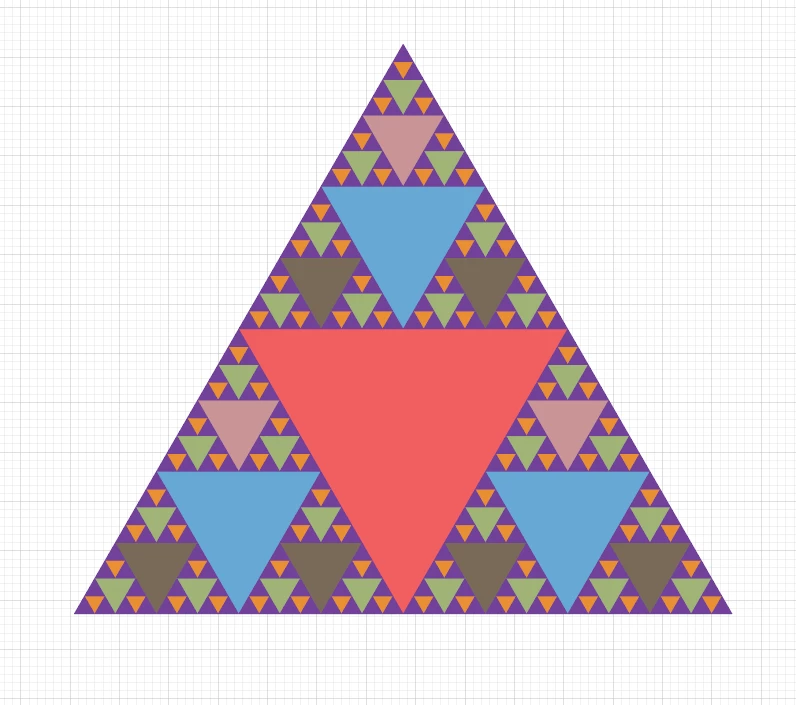

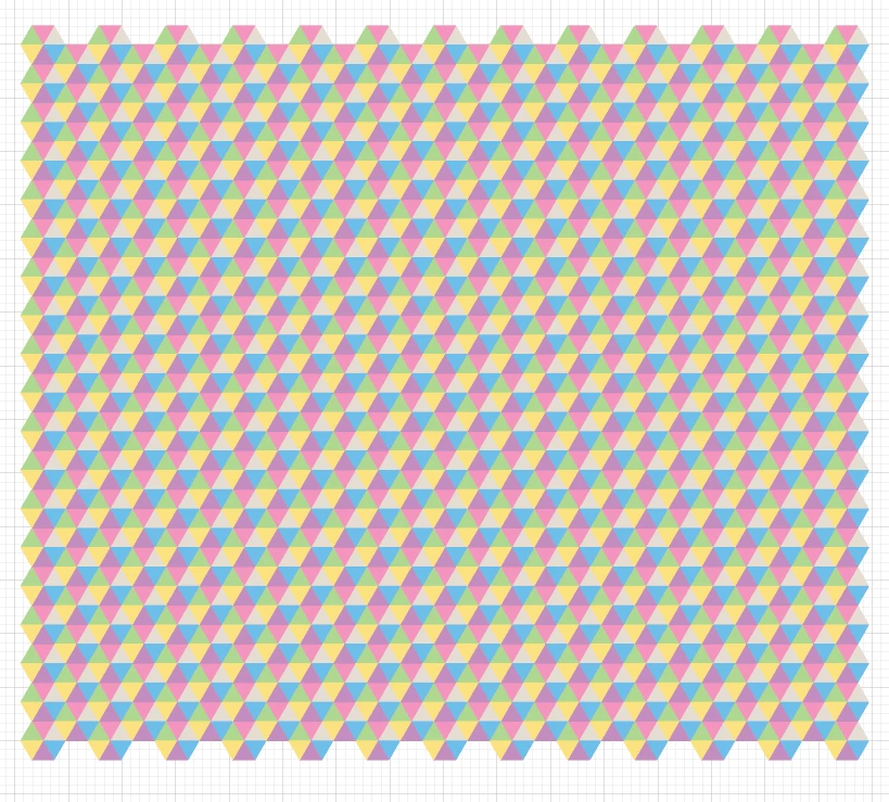

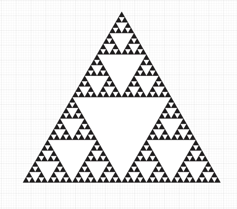

Hi Everyone,
I have attached two files. Is there a way to recreate these patterns in illustrator?
I tried poking around to find some answers, but I wonder if I'm having trouble finding the right direction because I don't know what to call it.
Any help with this would be greatly appreciated.
Thank you so much
Matt
Correct answer femkeblanco
Here's a script that draws a Sierpinski triangle that fits the open document.  The number of recursions can be changed by changing the number of "levels" in line 2, although it is advised not to go too much above 10, otherwise Illustrator may become unresponsive.  Adapted from:  https://www.youtube.com/watch?v=e3Ll0_oxChU

femkeblanco
femkeblancoCorrect answer
September 10, 2023

What I do know is that a hexagon divided into 6 equal segments= 6 equilateral triangles.
So to recreate this Sierpinski triangle, I created a seamless hexagon pattern.
Next Live Paint. I random recolor as I work.
Expand Live Paint. Pathfinder>Unite each unique color.
Recolor as you like.
Here is what it looks like with simple black and white.
K
