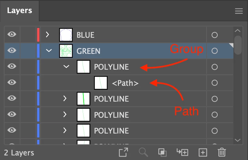

It was confusing, because the groups are called "Polyline".

I attached the file.  Some background.  This is a dxf file that is created in Cut2D and exported as DXF.  I also tried to export as AI, EPS, SVG but the program only maintains the true layer names with DXF.  We use the DXF files to create pictures for our website by coloring in the different layers.  It is the picture creation I am trying to automate.

Thanks @robertp99924539, it always helps to have a sample file. The problem was that every pathItem in the DXF artwork was grouped (each group was called POLYLINE). So here's a slight adjustment to the script:
var greenLayer = app.activeDocument.layers.getByName("GREEN");
var swatch = app.activeDocument.swatches.getByName('Birch Product');
var stroke = app.activeDocument.swatches.getByName('New Pattern Swatch 9');
for (i = 0; i < greenLayer.groupItems.length; i++) {
    pathArt = greenLayer.groupItems[i].pathItems[0];
    pathArt.strokeWidth = 2;
    pathArt.strokeColor = stroke.color;
    pathArt.fillColor = swatch.color;
... or you could just Select All and then Ungroup, and then run your original script. (Assuming that you've put the Birch Product and New Pattern Swatch 9 in the document.)
