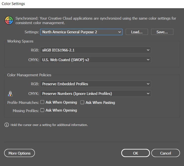

    How is your color management set up?
    Which color profile is applied to the document?

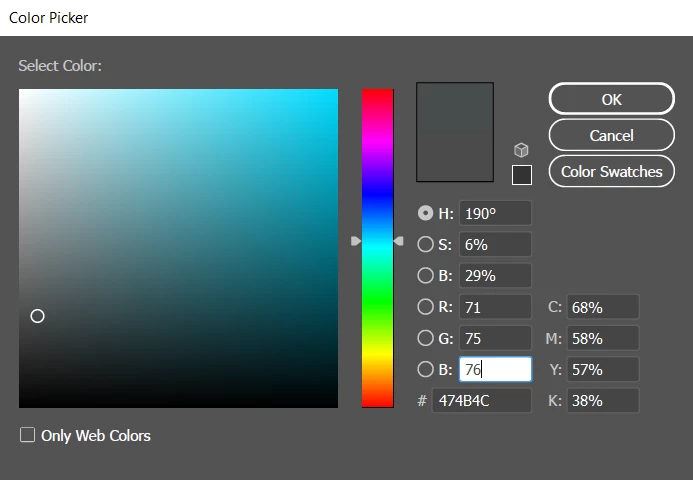

    January 5, 2022
    Hey, Thanks for the reply!
    Attaching the images here
