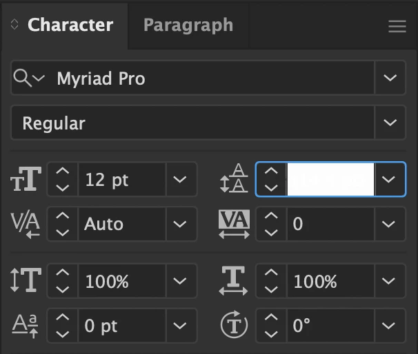

Just noticed this recently... when Dark Mode on macOS Big Sur is enabled, click in a palette field and then tab to the next field. It's now completely white, so you can't read the text. So any highlighted field in a palette becomes unreadable. This goes away if Dark Mode in macOS is turned off. Illustrator's interface darkness has no affect on this bug.

The problem appears to be with the Accent and Highlight colour settings that can be changed in System Preferences/General. When these are changed from the default colour (graphite) then any highlighted text within Illustrator is then visible again. See image attached. It's now working fine for me so I hope this solves the problem for anyone else who finds the same issue/glitch. Thanks for your help with this.

Hello. macOS Big Sur 11.4 and latest version of Illustrator. Deleting prefs makes no difference. It appears to be a visual glitch only when macOS dark mode is turned on. It's not just the Character panel. I only picked that one as a screenshot example. However, at this moment the problem isn't happening so there must be something else that's triggering it. If I figure that out I will post here.
