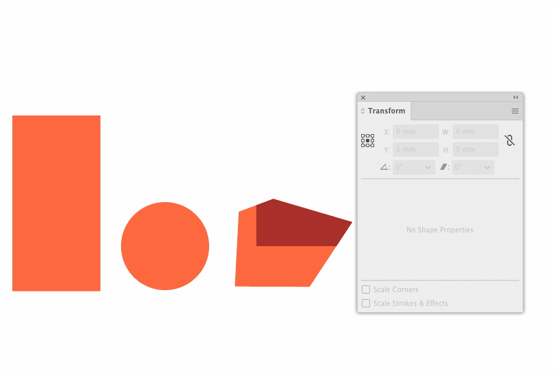

I am trying to write simple script that reduces hight of selection (single object or many objects on different layers) by fixed parameter. In my case 6mm. The problem is that in result redictionis 2.117mm instead of expected 6mm. Do you have any clue why and how the proper code wshould look like?
var doc = app.activeDocument;
var sel = doc.selection;
for(var i = 0; i < sel.length; i++){
sel[i].height = sel[i].height - 6;
Correct answer Sergey Osokin
Perhaps you can use the ResiteToSize script for this and other tasks to change the absolute or relative size https://github.com/creold/illustrator-scripts/blob/master/md/Item.md#resizetosize

Thnak you. I am just trying to automet hight reduction dependin on the file name I work on. But it doesn't work properly.
Basing on the latest response my code is as below but. Transformation is not correct and it is not centered.
For me inportant is also that reduction should base on selection and its bounding box size, so the masked elements or pictures would have no influance on transformation.

Sergey Osokin
March 17, 2023
You forgot to convert the newHeight variable to mm.
quote
Transformation is not correct and it is not centered....reduction should base on selection and its bounding box size, so the masked elements or pictures would have no influance on transformation.
This is wrong. geometricBounds is defined incorrectly for the clipping group. So the transformation is not from the center of the mask shape, but from the center of all elements in the clipping group.

March 17, 2023
Hi @irek289170064v73, scripts use points for measurements by default. So you can do it like this:
var mm = 2.834645;
for (var i = 0; i < sel.length; i++) {
    sel[i].height = sel[i].height - 6 * mm;
 There are other ways, but I find this very simple and I prefer it in almost all cases.
