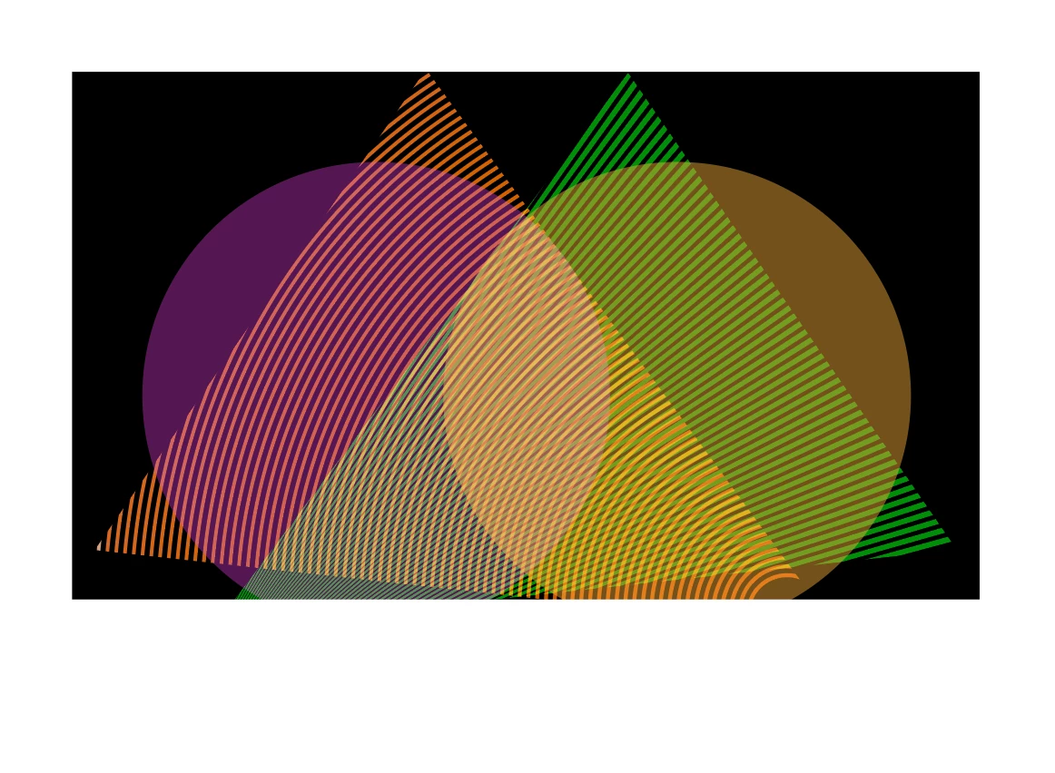

The lines are not horizontal and not "lines".
I don't know in which way they was created.
But you should be able to simulate a similar drawing.

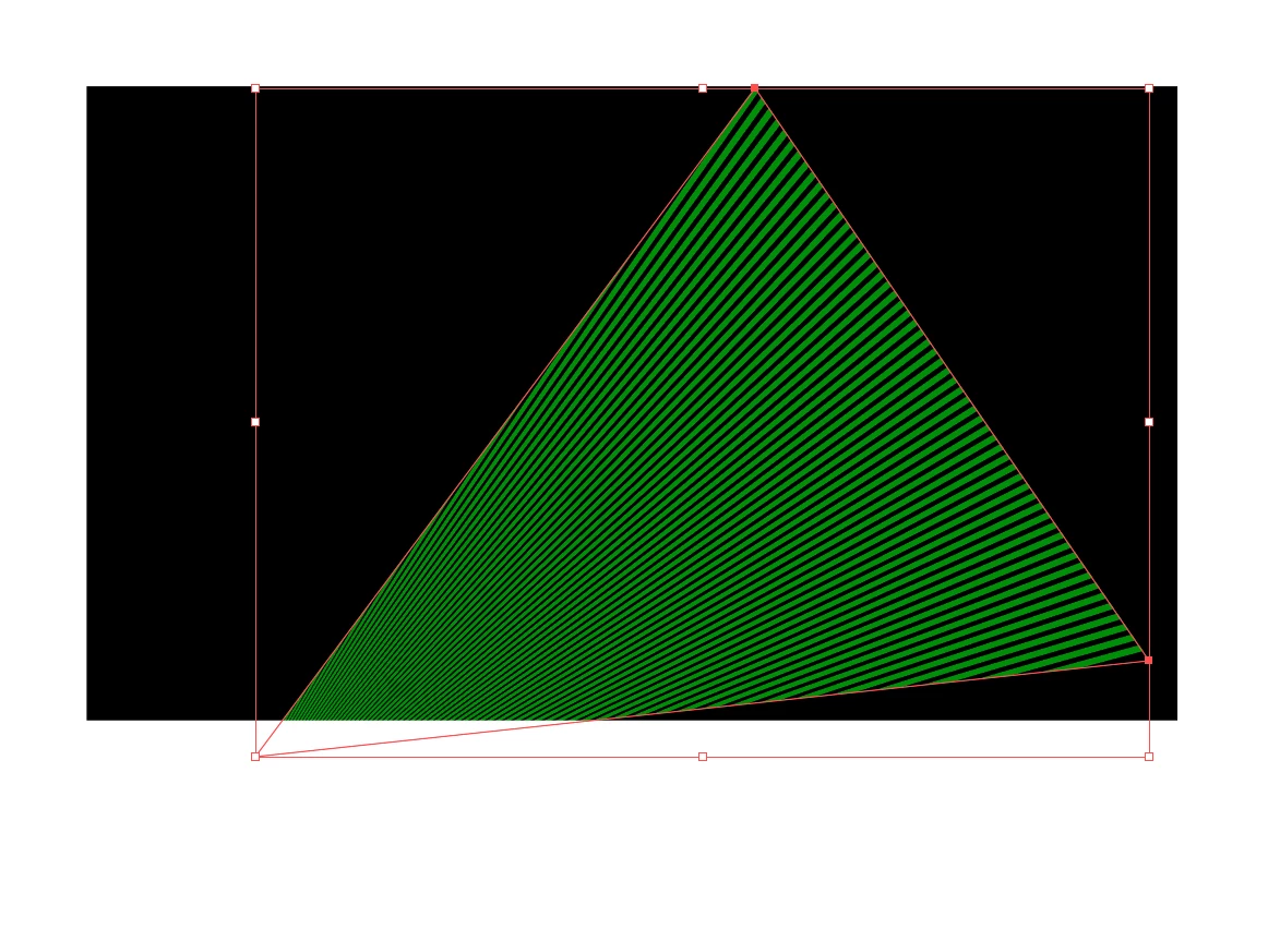

Create a long vertical rectangle (for example 0.05in x 8in) and remove the lower right anchor point. You'll get a long triangle. Use transform effect as shown in the following screenshot.

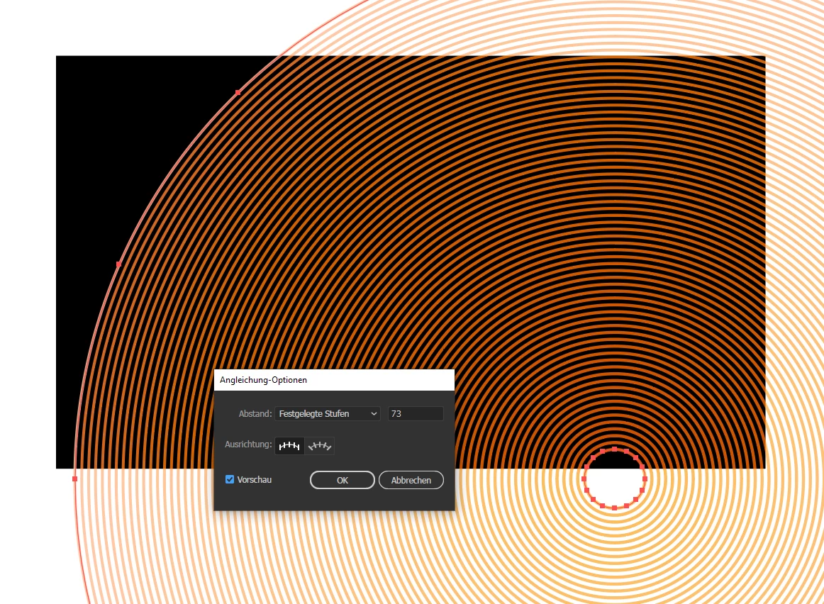

The other structure is a blend between two ellipses.
And last not least: the final result depends very much on combinations of blend modes and different opacities.
