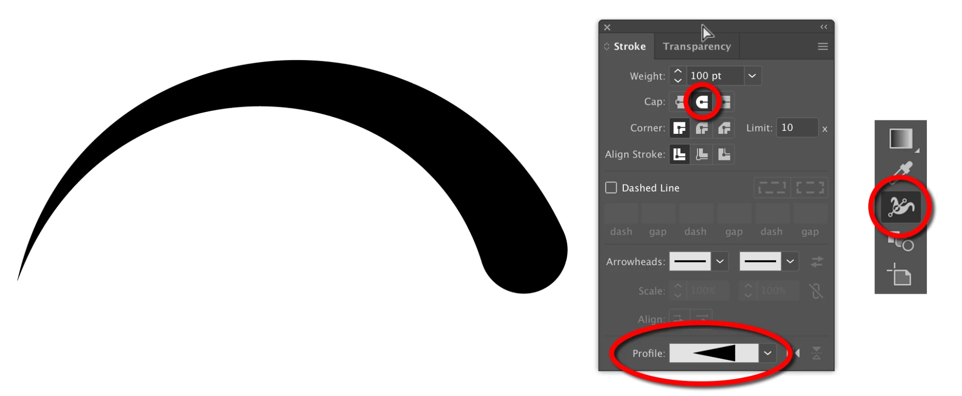

    I drew an arc with the Pen tool
    From the Stroke panel I adjusted the weight and added a Round Cap.
    Using the Width Tool I then pinched one end. You can see the result of using the Width Tool at the bottom of the Stroke panel in the Profile section.

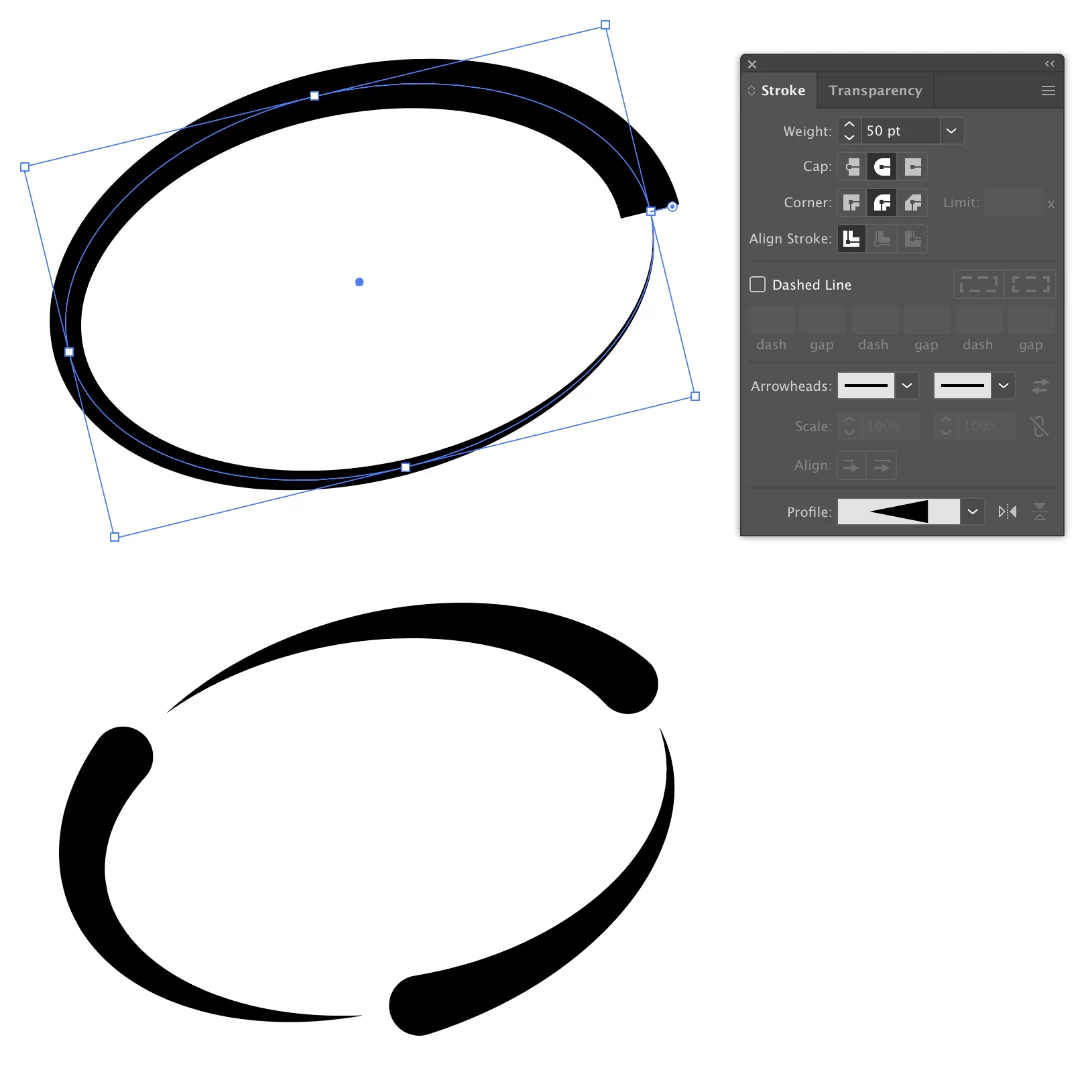

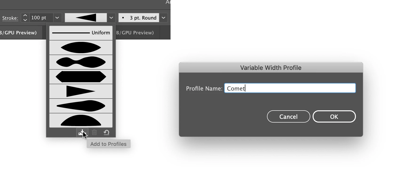

    If you like the Width Tool option you can also capture it as a Variable Width Profile for later use.
    Here I drew and rotated an oval to which I applied the Variable Width Profile. With the Scissors tool I then cut out small chunks.
    Technically my recreation differs from yours in that the tail of one comet aligns with the middle of the head of the previous comet whereas yours align to the outside. This is an easy fix by creating a non-symmetrical design in the first place with the Width Tool.
