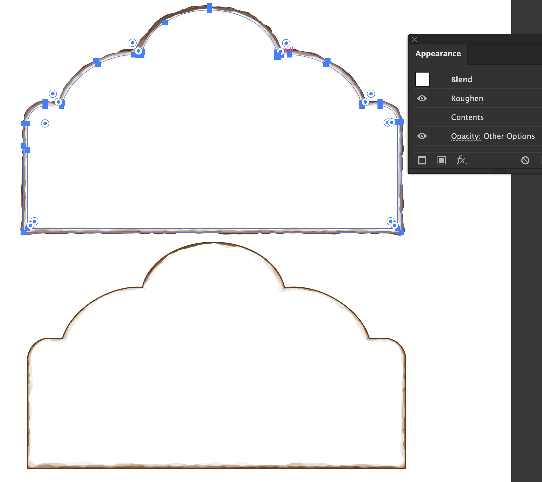

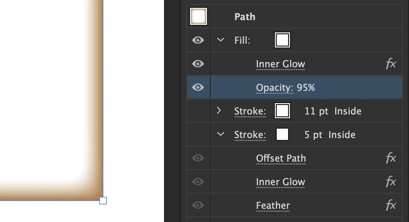

This is what I've been playing with. I like this look but not the inside of the stroke. I was thinking I could blend 2 together - is there a way to knock out the fill color and leave the effect behind - the inner glow - like you can in Photoshop?

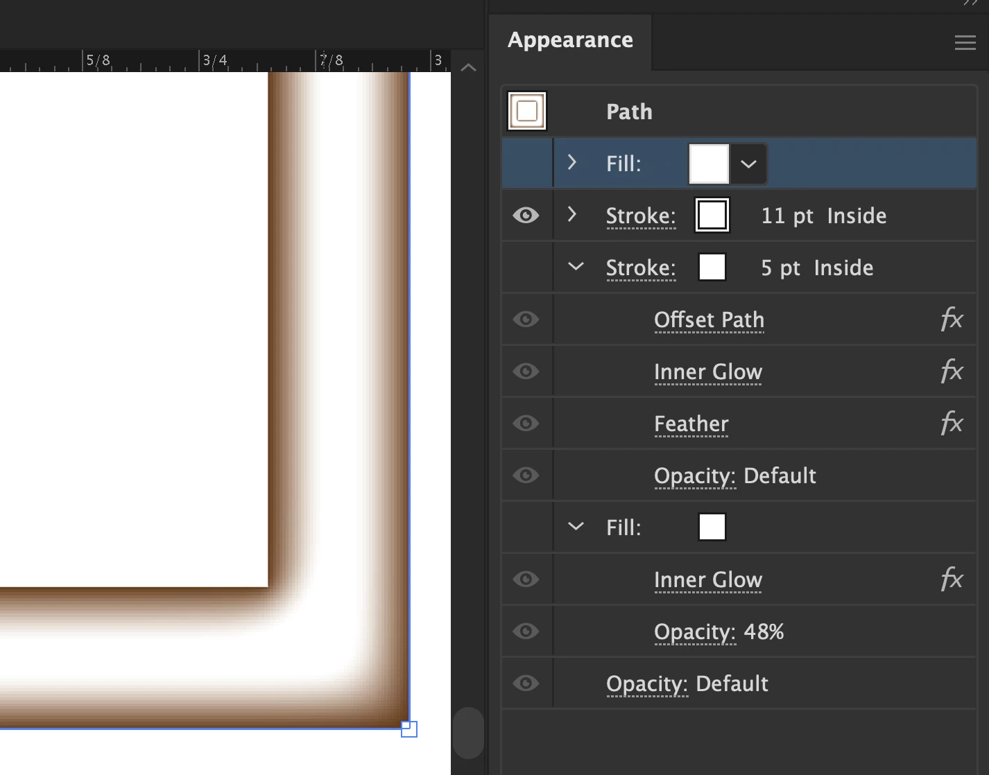

 And this is just boring and too uniform.

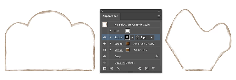

Correct answer Ton Frederiks
You could try custom semi transparent art brushes.
I used 2, one is a copy that goes in the other direction.
I added a simple 1 point stroke at the top.
This stroke will be used by the Pathfinder Crop effect at the bottom to clip the art brushes.

Ton Frederiks
Ton FrederiksCommunity ExpertCorrect answer
July 23, 2021
melissapiccone
July 24, 2021
Looks great and much faster then my way. How did you make your brushes? I don't make them in AI, just in PS. Did you just draw some lines and turn it into a brush?

Ton Frederiks
July 24, 2021
I played with some of the watercolor brushes, dragged them out of the brushes panel and roughened them (and simplified them because they became too slow, they are still quite heavy). Dragged them back and used Tints for the colorization method.

I got the look I was after but it's not a style. I would have to do it individuallly to each shape. I offset the path to make a second shape. The back one is brown, top one is white. I created a blend between the 2 and applied roughen to the white, smaller one on top. then I created another full size shape to use as a clipping mask so the edges are straight. It works but it would be fantasic if I could make it a style.

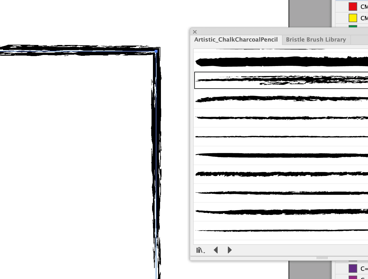

Brad @ Roaring Mouse
July 22, 2021
If you want something that specific you may want to stay in Photsohop,
but you DO have many ragged brush styles in Illustrator you can add to strokes, etc, and maybe build your look with various combinations thereof.
melissapiccone
July 23, 2021
I did try using some brushes and considered making some custom ones but I was't getting anywhere near the results I was after.
