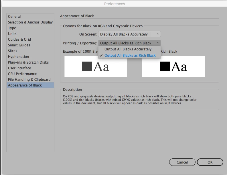

    Jacob Bugge
    August 1, 2017
    Takashih,
    I wonder whether your printer is overly helpful and (believes it) performs colour management; maybe there is some printer setting you can switch off.
    gökhanyaka
    July 28, 2017
    this situation can be related on below menu. check your preferences.
