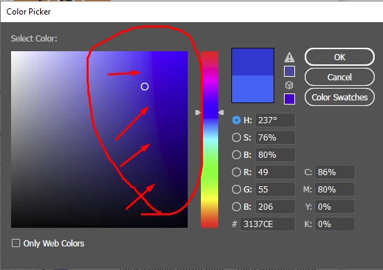

Hello sir ,
Recently i am using zotac brand GRAPHIC CARD 3060ti and also i am using 27f HP monitor . in this computer the Adobe Illustrator and Adobe photoshop color setting is not working correctly please check the attached . but other apps adobe primire pro and adobe after effect is working properly .
THE MAIN problem is the color blue and pink is not showing blending properly .
Please check the attachment and let  me know how can i solve this issue

Willi Adelberger
May 2, 2022
I suppose that your file is CMYK. The color gamuth of a CMYK file is different to a RGB file. Bright pink, green and blue colors cannot reproduced with CMYK, so they are shifted to the next CMYK value. You recognize it, when a triangle is shown above your colors as in your screen shot.
