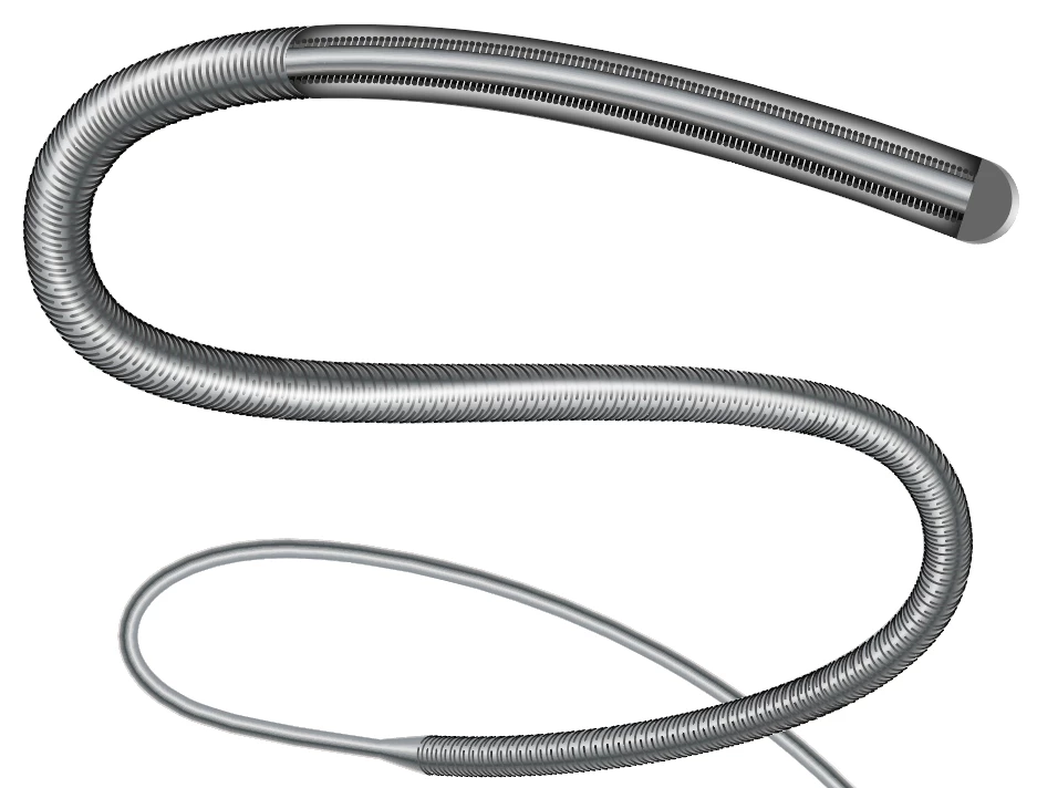

How can I get a consistent blend on the laser marks throughout the (gray) length wire, taper and curves?
I have created blends to represent a laser-mark effect on a metal wire. The wire has a taper/curves. How can I get a consistent blend on the laser marks throughout the (gray) length wire, taper and curves?

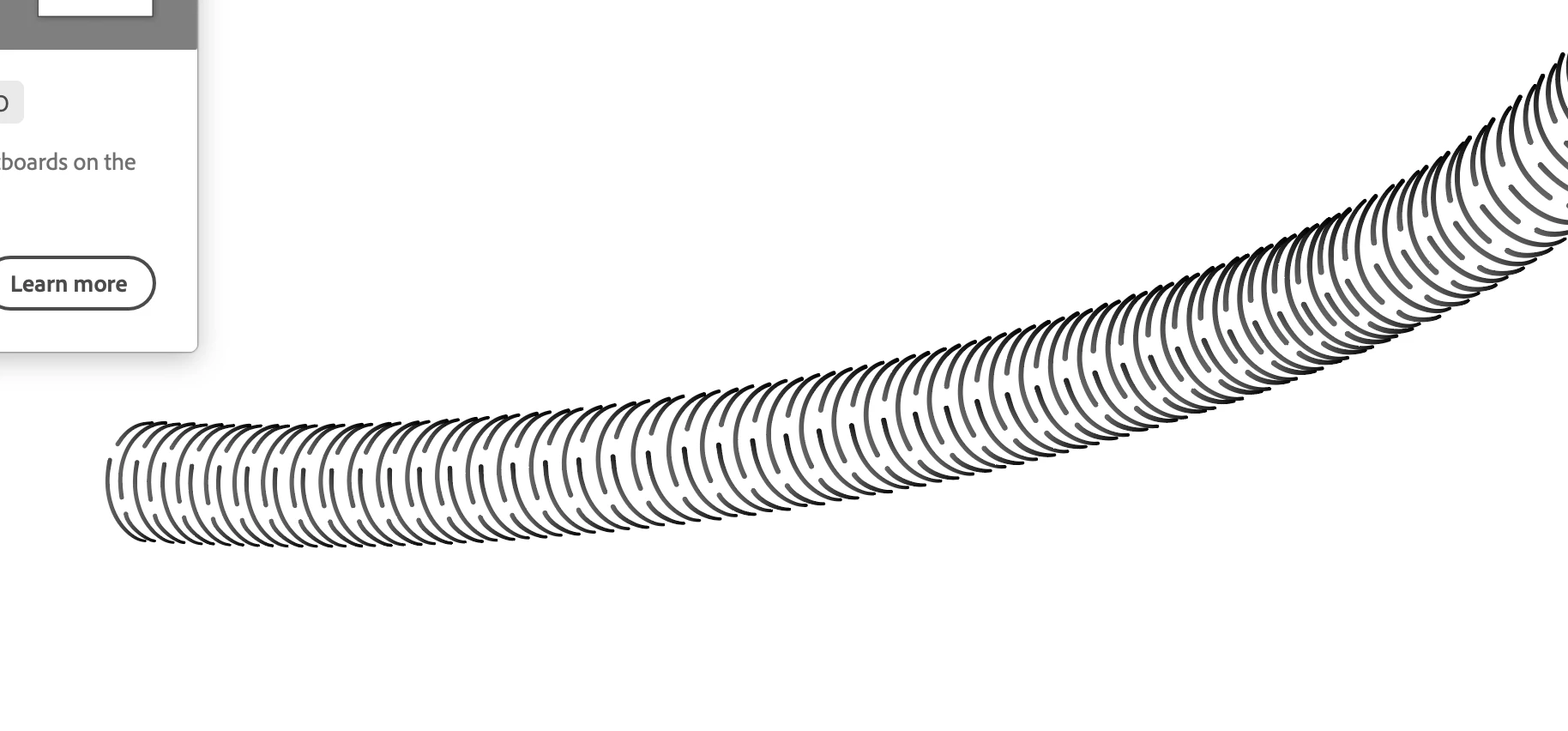

    alesel31541862
    May 5, 2026 2:25 PM UTC
    See the screen captures attached. Is there a better way to create the laser marks than what I am doing currently? I’m having difficulty keeping the blends equally spaced, even though I have tried to do the “specified distance” and “specified steps”  in the blends.

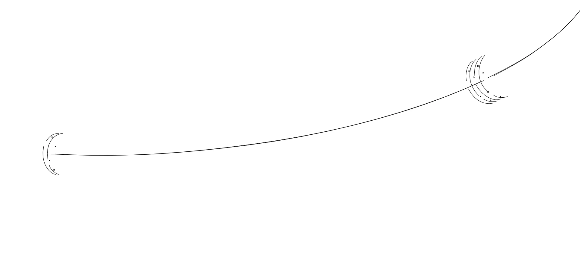

    Monika Gause
    May 5, 2026 3:39 PM UTC
    In order to define the spacing in the blend, use the handles of your blend spine.
    Apart from that: have you tried brushes? Probably make a straight blend, then an art brush? Or make a pattern brush instead of a blend altogether.
