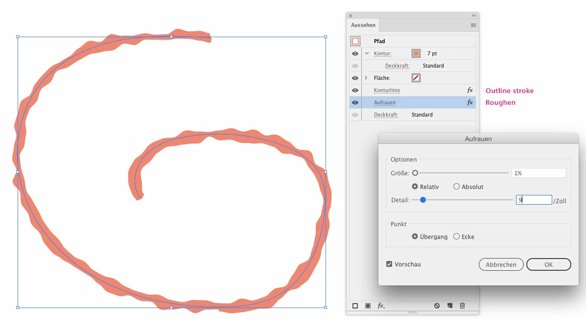

    Monika Gause
    December 5, 2016
    You can also create a Graphic style with the Outline stroke and the Roughen effect in this order:
    Can also be applied to brushes strokes to make them more irregular

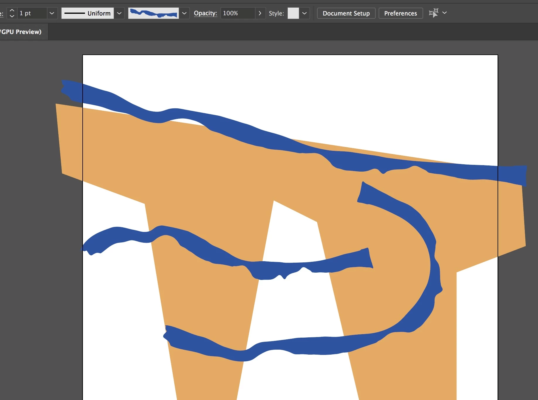

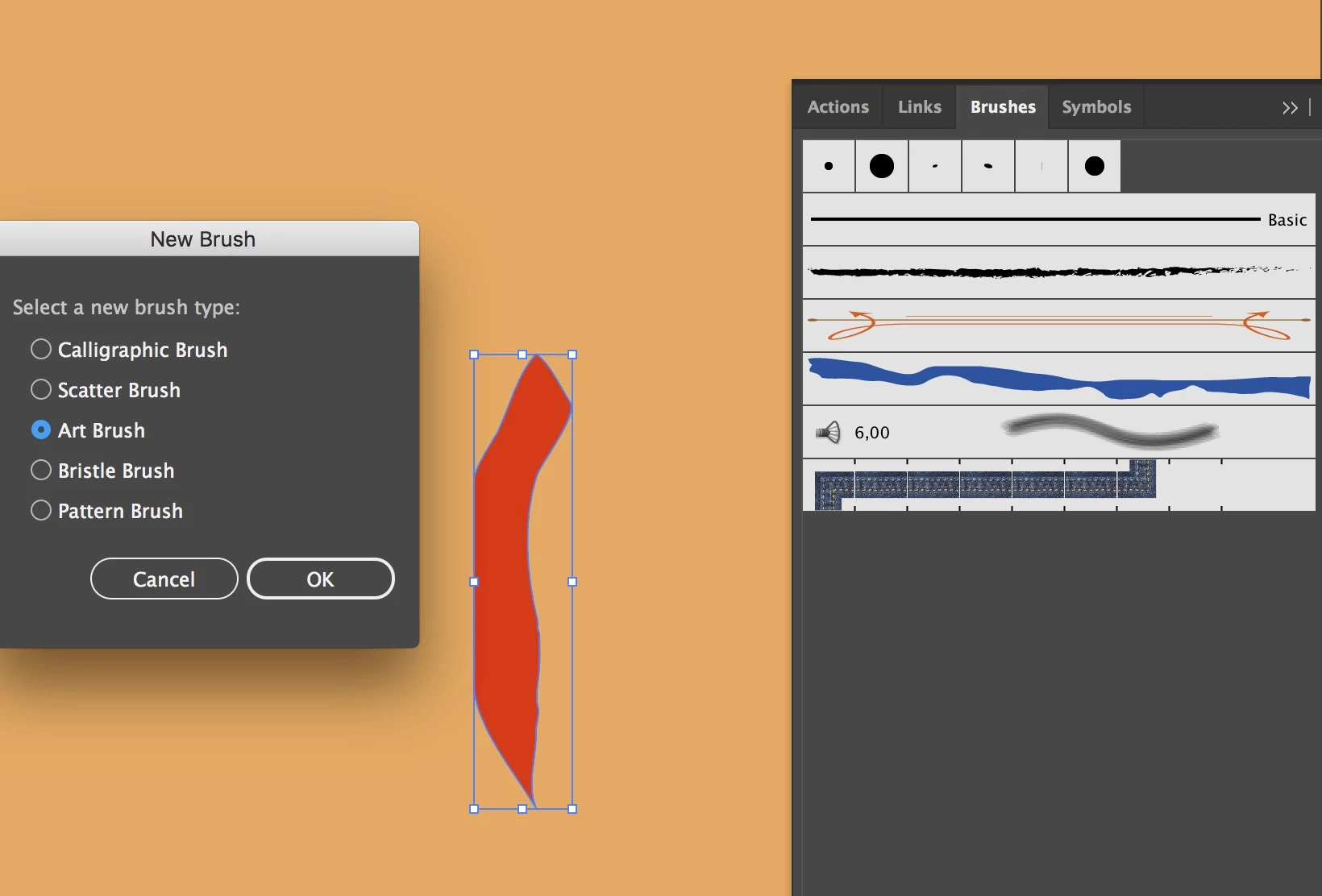

    Hi Zoe.
    You can create a brush. Like this:

    Grant H
    December 5, 2016
    same applies, create a shape (shapes) for the fur and create a brush. You can experiment what will work best for you and the type of brush you want...
