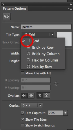

    Sounds like you used an option other than grid, when making the pattern. Unfortunately in my testing the brick and hex options make an additional linked copies of each placed .jpg, and that makes your files large and  slow.
    There is no solution for this exact issue, but would suggest posting a bug request
    Feature Request/Bug Report Form
    Logically would appear that the Adobe development team, should be bale to reprogram this to only use one link for hex and brick options, but not sure how difficult that would be of them.
