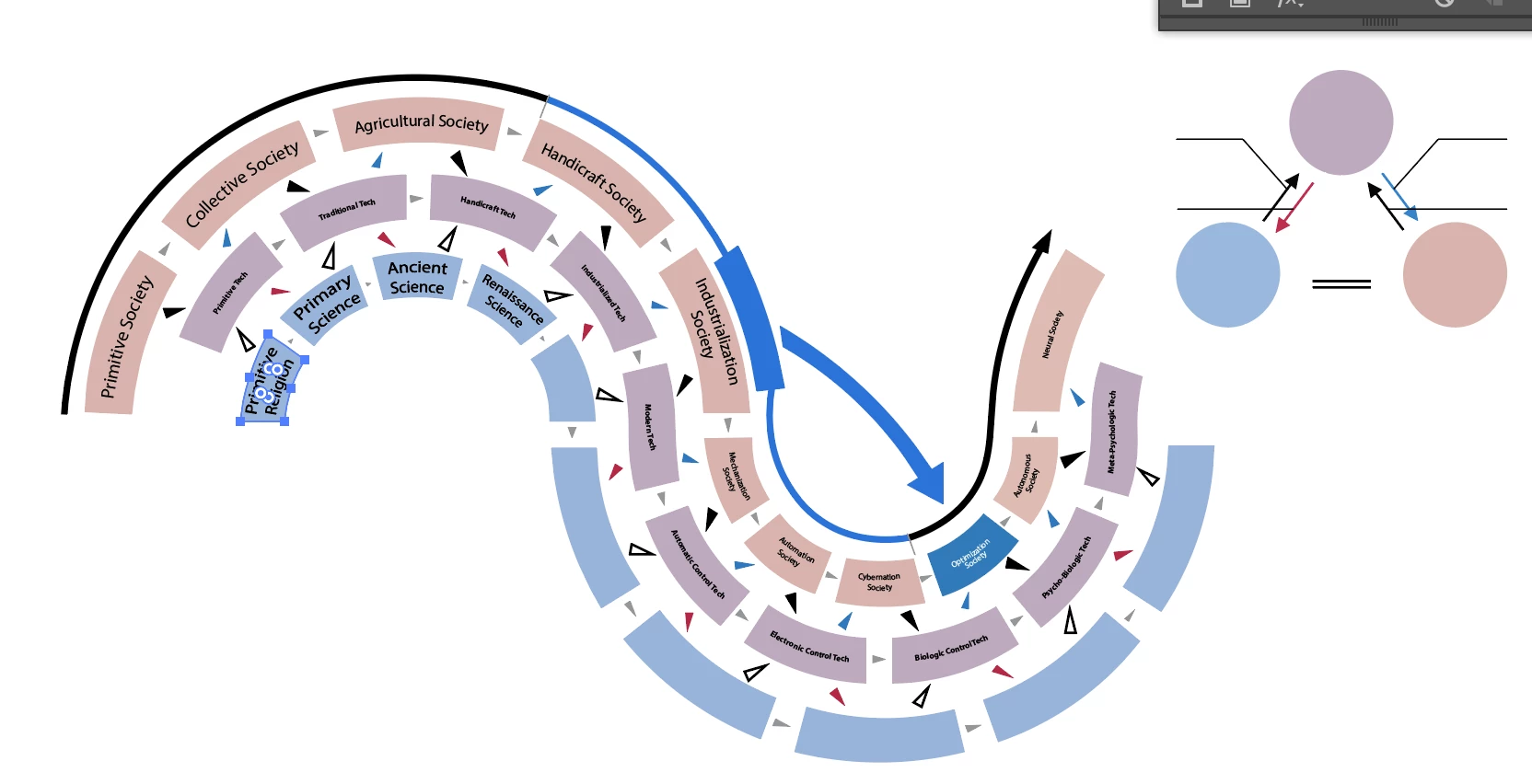

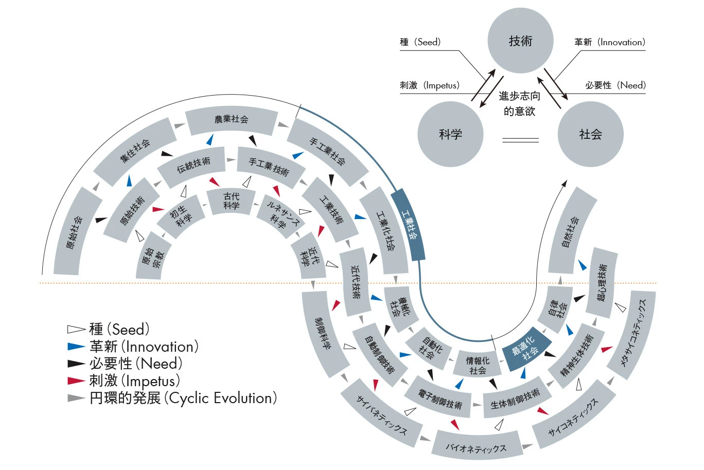

Hi humans. I am trying to recreate the picture below. Now I need to put the text in its place, but I couldn't find a good way to do so. Let me explain with screenshots:
This is what I am trying to recreate.

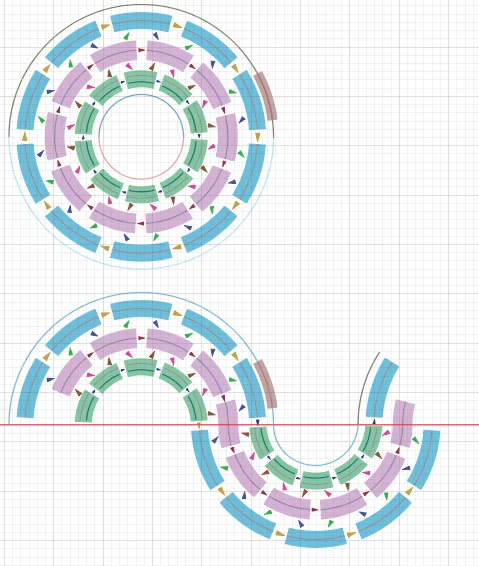

I made the shapes with the pen and curvature tools:
I am not happy with how the text looks, I think fitting the text inside of the shapes would look nicer.
But when I try to do that using the area type tool:

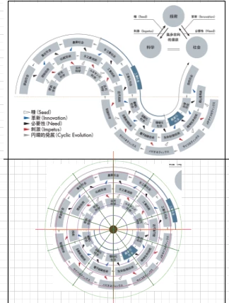

Reverse engineering:
It’s a radial (concentric circles) with shapes and live text, all rotated from center.
Copy and then move, over.
Fill and/or Strokes, Scissor cut, Transform, Smart Guides, Type on a Path>Center Align text were my friend.
Not hard, just a process.  (Fun to do)
Here are a few screen shots with my process.

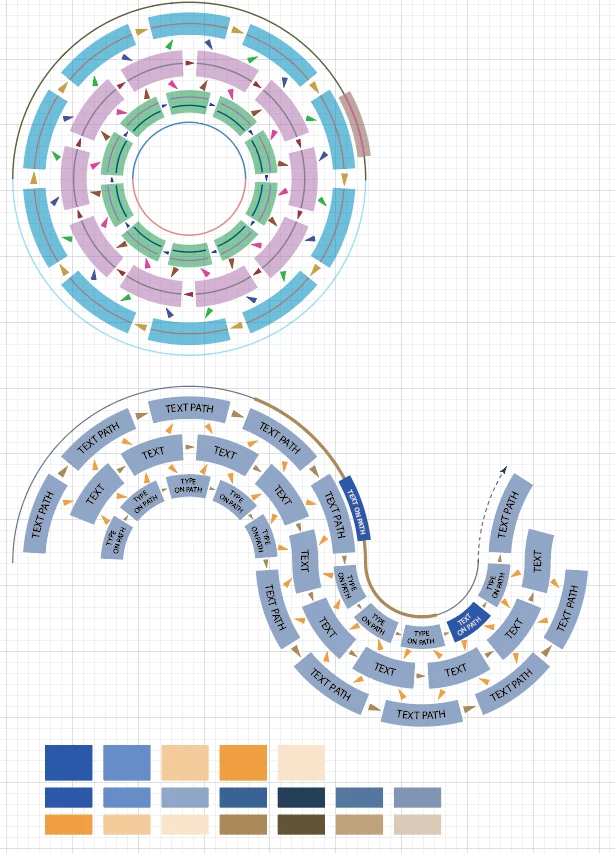

orkhon, Hi.
As mentioned by Mylenium, clearly the best approach here is to use Type on a Path.
Now trying to modify a given/purchased file to now fit your needs???
Thank you for providing a screen shot.
It’s very nicely constructed Info Graphics as an inspiration piece.
Illustrator is good for this one.

Use an object based warp and text on paths rather than area text inside objects. Lay out the text as a regular straight line, then bend it into shape, create duplicate paths of the warp shape to create the text.
