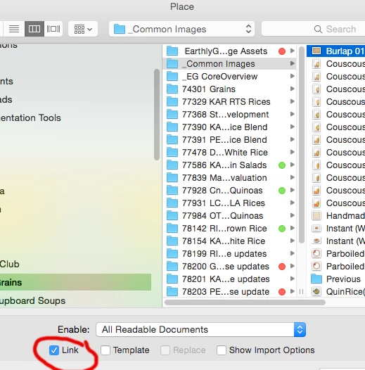

Dear Mike,
Thanks for the answer.
See attached that in any case my link option is available... Neither with place neither with open...
Should I update my illustrator versions? I'm running with cs5.1
Bests!
<A>
Mike_Gondek10189183
March 9, 2017
Link is only available during placing, your open command is correct as you cannot link during open.
That during place  your link option is greyed out during place appears to be your issue/question.  Can you try with other file formats to give us more information, such as a .psd or .jpg. You usually can link to an .ai file, even if pdf compatible was off
