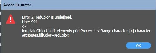

templateObject.fluff_elements.printProcess.textRange.characters[c].characterAttributes.fillColor=redColor;
This line of code here is what I have found which i believe controls this text I need to change the colour of.
I have tried to change the cmyk values here, but this produces the error as follows.
Any help would be appreciated!
