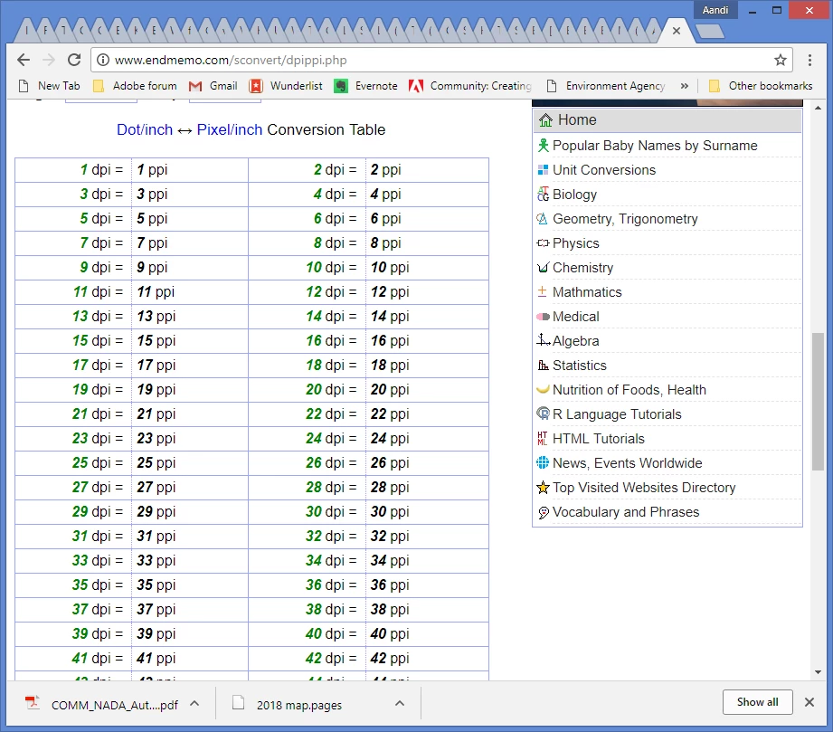

    There are dpi<->ppi converters on the web? So there are, just as there are RGB<->CMYK converters put up by people who nothing about the subject but know how to count clicks, and know that people who know no more than they do go looking for fantasy information... Here is something from the first dpi<->ppi converter I found:
    Well, that should come in handy.
