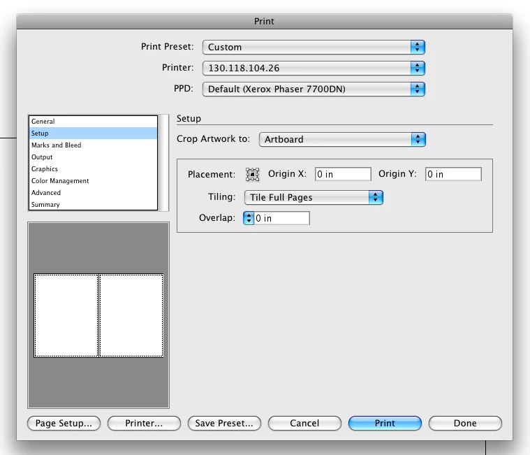

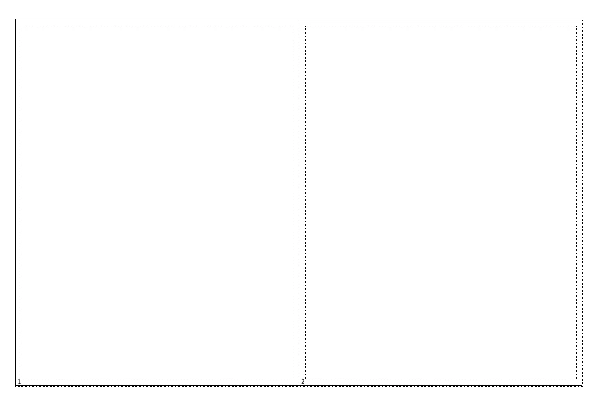

    Yes, only one artboard per file but you can make it the size of two regular pages and then use th tile full pages checkbox to make two pages. You will have to save each page seperately in CS3 and combine in Acrobat. Make a New Document and select 11 x 17 landscape. Then go to the Print dialog and choose Page Setup. Set it for 8.5 x 11 portrait. In the Setup tab choose Tile full pages. Click done. Make sure show Page tiling is on in the View menu. It should look like below

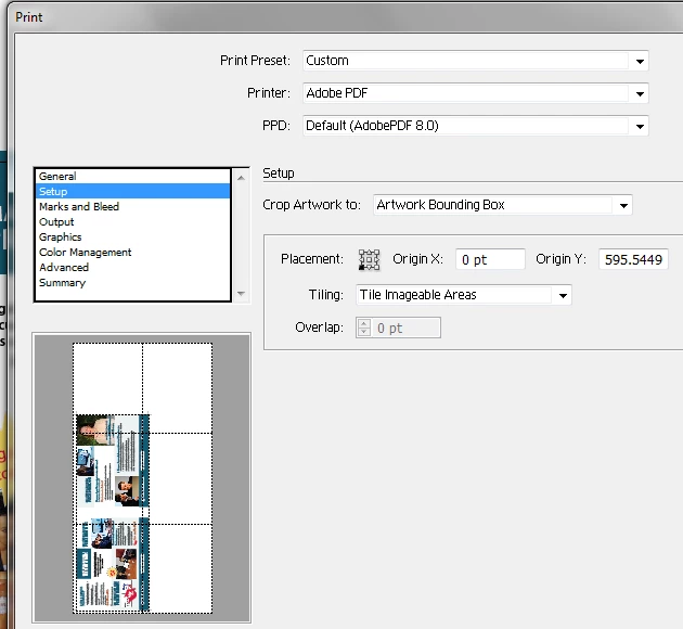

    May 3, 2011
    Then how do I specify the area to tile? In the Print dialog box, under Setup, there's a section for tiling. If I choose Artboard Bounding Box under Crop Artwork To and Tile Imageable Areas under Tiling I get both pages, but the page divisions aren't in the right place and it's going to make 6 pages!
