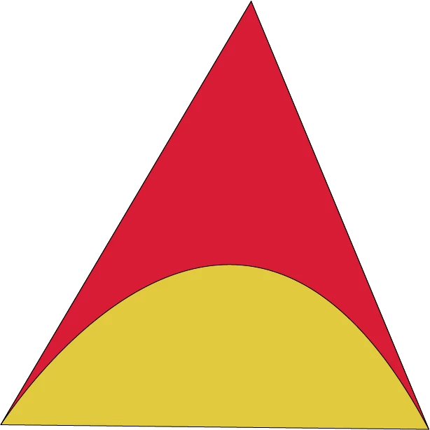

I just started learning Illustrator so I set myself the challenge of a 2 colour triangle.
This is a red triangle with a yellow semi circle placed on a higher layer.
But with a future project in mind, I really wanted to create it like a patchwork - two shapes sharing a border. Like this picture, but with extra tweaking to get the edges to align.
Tutorials that I have watched so far only demonstrate overlapping shapes on different layers.  Am I just thinking about this in the wrong way with my patchwork quilt concept or is there some tool/technique I have yet to discover?

In your second image you have drawn two similar borders.
The key to the accurate (and easy) solution is to only draw one border, and then use it in one of multiple possible ways depending of the objects to share that border.

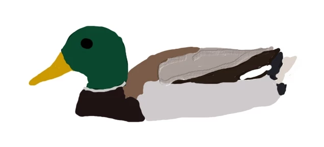

May 5, 2023
Thank you for the answers; I can see how they get my separate patches.
This image exemplifies my ultimate goal—a patchwork of about ten complicated shapes.  I admit it is my inexperience, but I am still unsure of the best way to approach this task.
