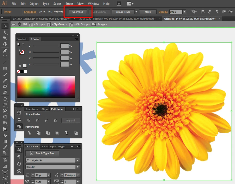

Aug 22, 2014 7:07 AM UTC
I had a similar problem with an embedded image I got from a client — the image was not on my machine and hence unavailable for re-linking.
To my (happy) surprise Illustrator CC has a feature to UNEMBED the image (don't know if this is also there in previous versions).
Double click on the image and in the horizontal bar you will see the UNEMBED image button (screen shot attached).
Clicking on the button gives you the option of saving the image to disk as a PSD/other file.
