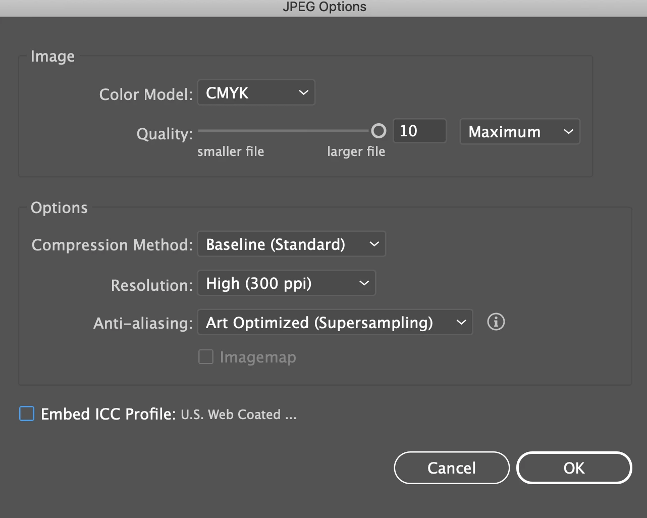

I create my layout in illustrator using a photo, text etc, with my artboard at 3 x 5 and my raster effects set to 300.
I use the "export as:" and I get the following dialog box (see attached)

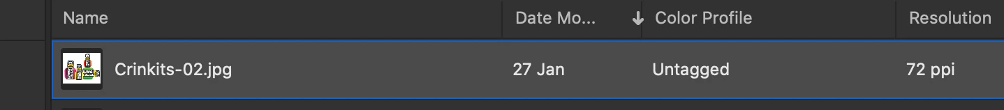

I choose 300ppi, all good. then i go to check out the image in my bridge and voila: 72ppi.
why?
I know that in photoshop, the only way to achieve this - is do a "save as" and save as a jpg to retain the 300ppi setting. this does not work in illustrator. what for the love of adobe is the secret trick in illustrator?
anyone? appreciate the help. so sick of this continual issue!
Correct answer Ton Frederiks
It is probably a Bridge problem, placing the "72" ppi file in Illustrator shows 300ppi in the links panel.
Ton Frederiks
Ton FrederiksCommunity ExpertCorrect answer
January 28, 2021

This is true, i checked it. what a weird bridge issue! thanks!

Photoshop > Image > Image Size will show the actual resolution.
But there seems to be a difference when the jpeg is exported as CMYK or as RGB.
When exported as CMYK, Bridge shows 72 ppi, and when exported as RGB it shows 300.
It may be an Illustrator problem, (re)saving the CMYK file in Photoshop shows the file in Bridge as 300 ppi instead of 72.
January 28, 2021
To double check, open the JPEG you exported in Photoshop and look under Image > Mode. This will be the actual ppi from the file, if it is there, or some default (72 ppi? 90 ppi?) if it is not there. Disappointing if Bridge can't mange this simple trick.

Bridge is wrong, Photoshop is right.
