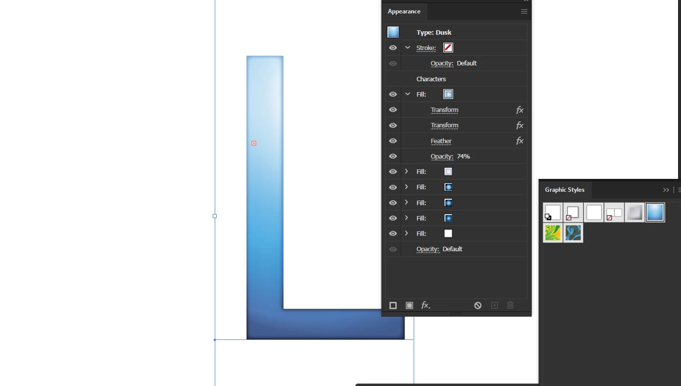

You are asking about vector art or raster?. It easier to do in Ps. Illustrator also have some raster effect or styles that are using raster effects. We need to create customize style and apply to type.
In Style we have Dusk style. In Appearance panel you can change color and other parameters.
August 23, 2025
I only have illustrator, not PS. Creating this appearance will will or will allow me to do this to the edge of the letters? I'm guessing I can find a video by putting in these things you've mentioned to learn how to use this?
