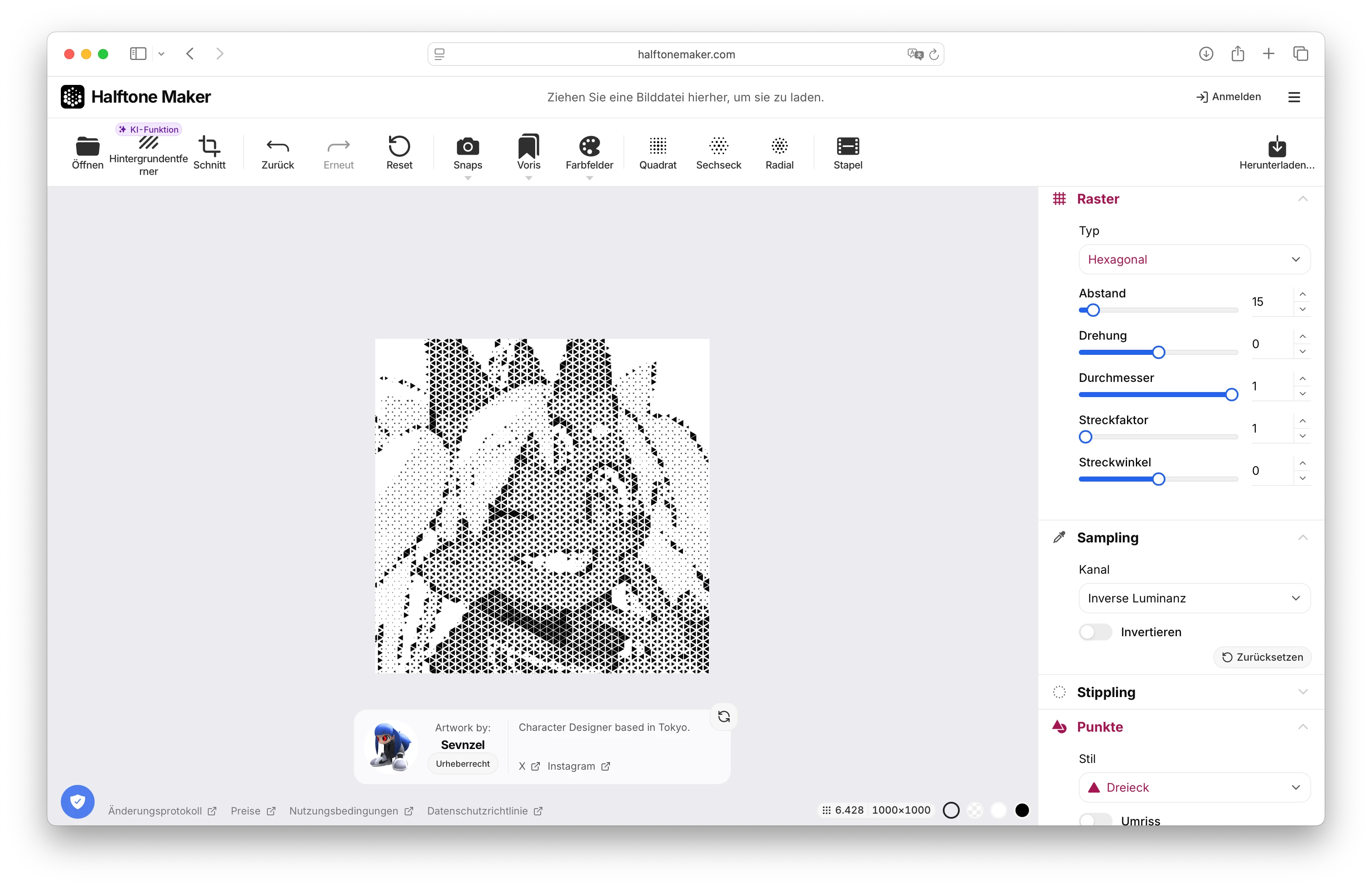

    Try Inkscape Tiled clones like this:
    Or Halftonemaker.com
    February 16, 2026
    Not bad at all...
    I'll try!
    grazie Monika :D
