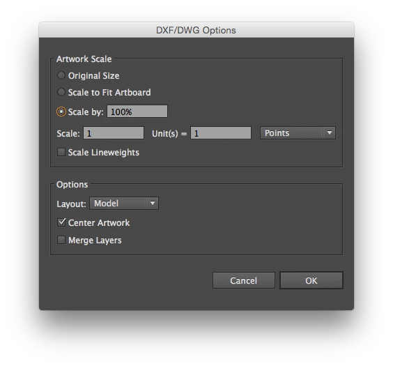

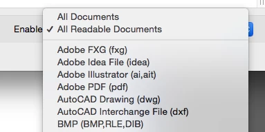

    Just use the open command to the default of all readable formats. .dxf is one of the formats.
    Choose original size or 100%.
    If those are greyed out then you get to play the guessing game size of what until the Auto Cad person was working in before they saved, and that they have dimensions shows on their file.
