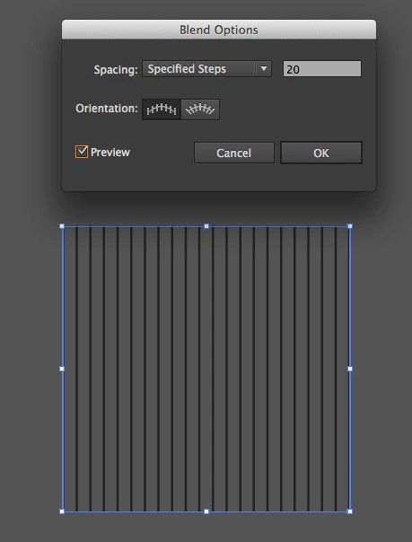

    first you need to create the lines. draw two vertical lines 1" tall andv 1" apart. select both lines and click Object > Blend > Make. after you've made the blend, click Object > Blend > Blend Options. check the "preview" checkbox in the lower left corner. click the flyout menu (i believe the default value is "smooth color"). select "specified steps" and enter different values in the dialog until the lines look the appropriate distance from one another. click ok when finished.

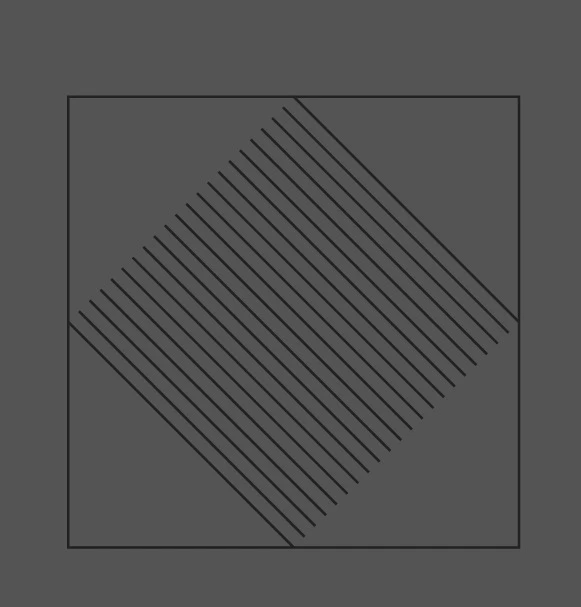

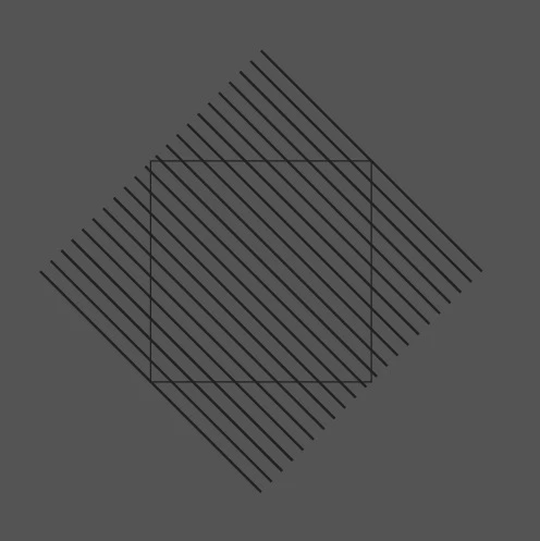

    at this point you have a group of vertical lines selected. rotate the group by 45* draw a box around the outside edges of the diagonal lines.
    now scale that down so that the entire box is inside of the diagonal lines.
    select both objects and click Object > Clipping Mask > Make

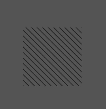

    duplicate this object and keep it off to the side (because if you need to adjust stroke width in the future, you'll need this). now select the original one and go to your Pathfinder palette and click "Crop". this gets rid of the clipping mask so you're just left with the expanded diagonal lines.
    now drag the expanded/cropped object into your swatches panel and voila. make sure to name the new pattern fill so you can identify it (you don't want to have several different patterns called "New Pattern Swatch 1" and "New Pattern Swatch 2" etc etc.)

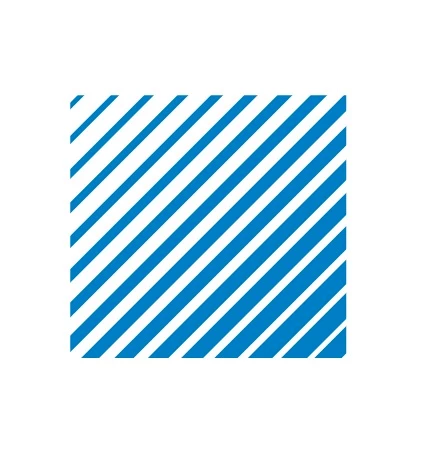

    are you looking for a seamless pattern fill? or do you just want an object to contain somewhat of a gradient of lines like this??:
    Jan 8, 2015 10:08 PM UTC
    Thanks William,
    I want to fill boxes with simple lines and control the line stroke. They can be just like what you demo, but uniform. See below.
