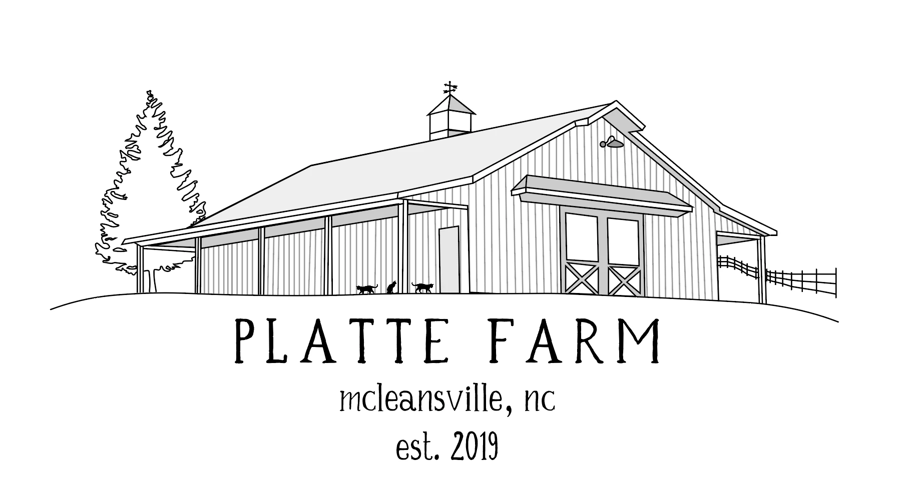

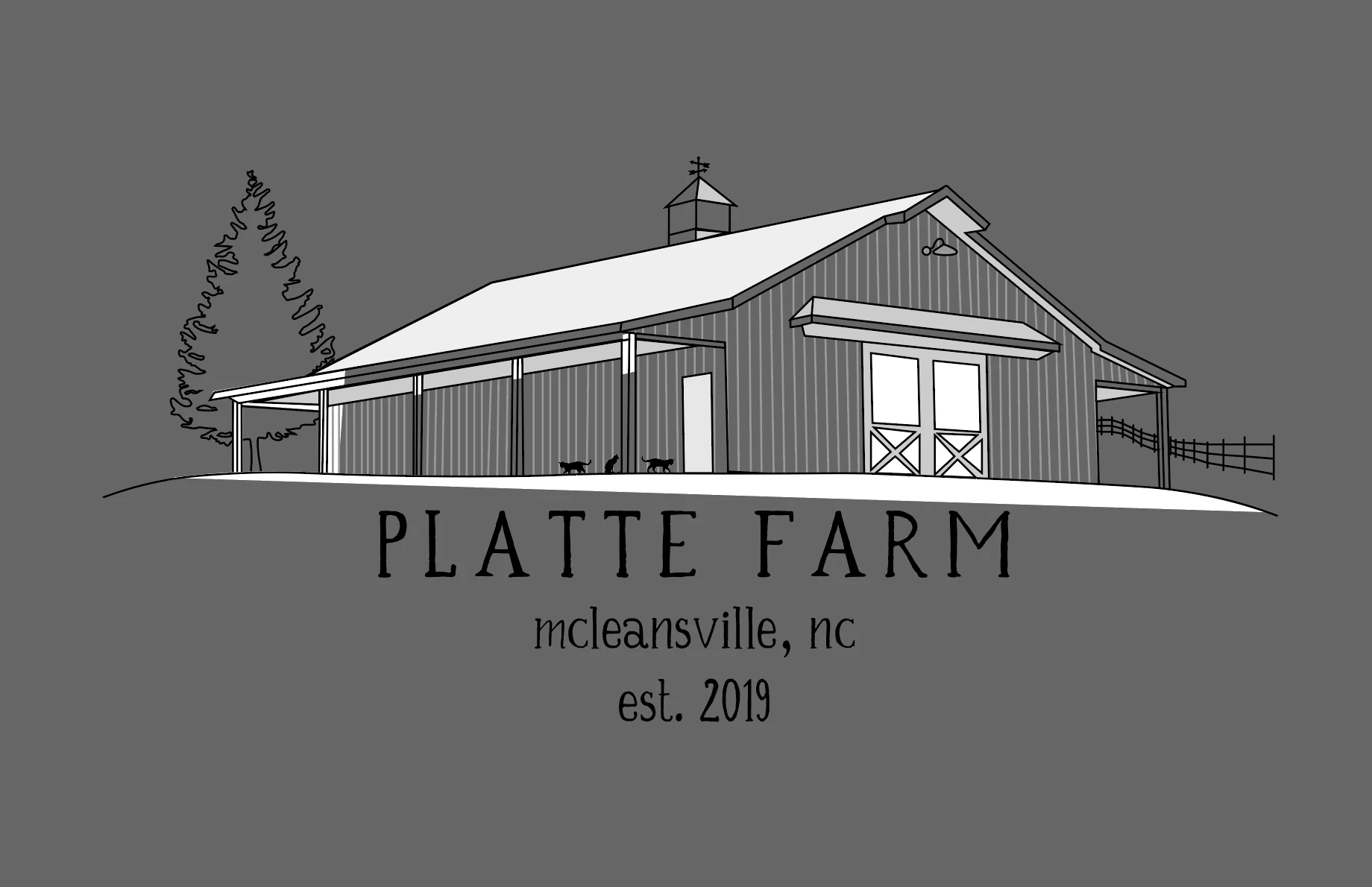

I made this little logo and used made an odd shape on the bottom to "cut off" the barn illustration. It is fine when on a white background, but this needs to be on a shirt and therefore I need to get rid of the weird white shape. How do I do this? I will put pics with a dark gray background to make the problem obvious.
Correct answer Monika Gause
select an object with a white fill with the direct selection tool. make sure the fill is active . then sect > same > fill. then in the appearance panel  set the white fill to 0% opacity . then group all and set the group to knockout group. in order toget this printed on certain devices you will need to expand it. use object > flattentransparency. set outline strokes and keep alpha transparency. afterwards clean up all the remaining invisible objects
キィィ─!!!
November 30, 2019
Hi, jluceydesign
The easiest solution is to group the barn illustrations and set the drawing mode to "multiply".
However, this works if the logo is black, but it can cause problems if the logo color is changed.
If change the color, please disassemble and shape with a pathfinder.
Monika Gause
Monika GauseCommunity ExpertCorrect answer
November 30, 2019
Larry G. Schneider
November 30, 2019
Try selecting the path above the white area with the Direct Select tool (Open Arrow) and see if the path has a white fill. If it does, delete the fill and just keep the path.
November 30, 2019
Unfortunately, that won’t work. The white fill is purposeful in that is is covering line endings etc that I don’t want to show. I figured out how to do what I want using the Magic Eraser tool on Photoshop but want to do this in Illustrator because I need it in a vector format.
