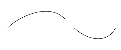

    If I'm understanding the question correctly,
    Let's say I have these two paths --
    I don't want any space inbetween. I want them to look like this

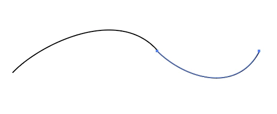

    Move hie two paths close together so that they appear to be connected, even though they are still two separate paths.

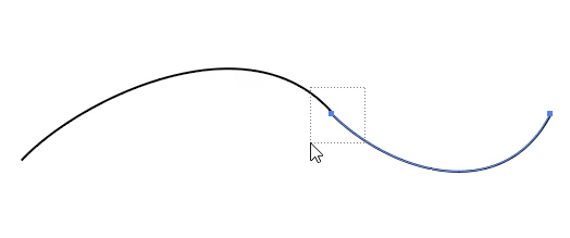

    With the Direct Selection tool, select the two anchor points you want to join.

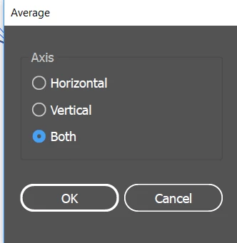

    Choose Object > Path > Average and click OK.

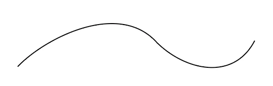

    Then choose Object > Path > Join.
    If you don't average them first, Illustrator will add a new path segment that joins the two.

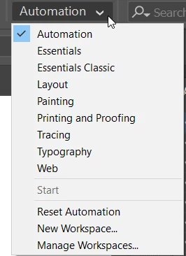

    To address the second part of your question regarding snapping,  under the View menu remove the checkmarks from the snapping commands.
    Also,  make sure that snap to pixel grid is off. Change to any workspace EXCEPT Essentials.
    In the upper right of the window, make sure that this icon is not selected.
