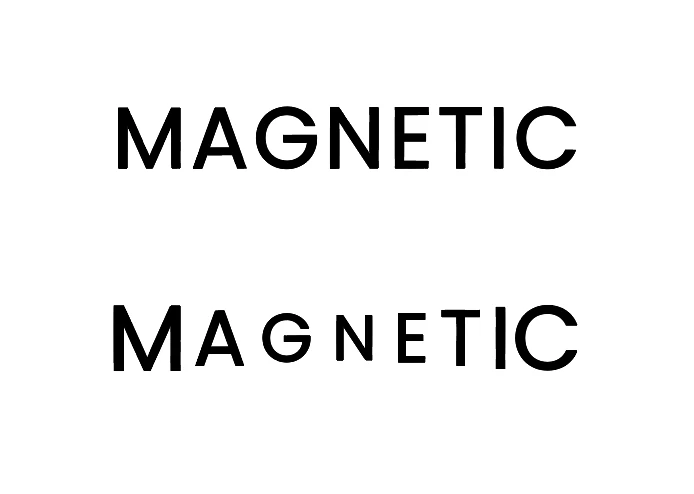

How can I make this smoother? I want the word to look like it's growing each side from the N.
I've looked at the effects but can't find anything that gives the right result.
I hope this makes sense to someone!

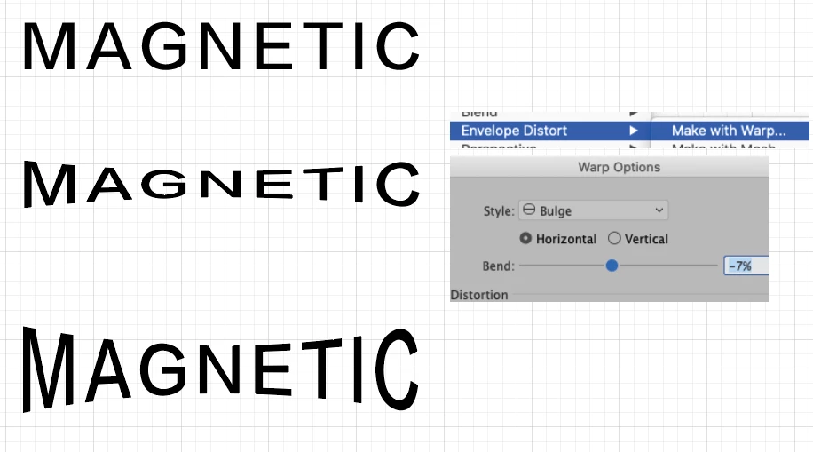

Becky, Hi.
To add to what has already been suggested,
Here I set my type.
Object > Envelope Distort > Make with Warp.
Here I applied a slight Bulge,-7%
Selection Tool (black arrow), drag downward on bottom center handle
You also have Options to Expand or Edit Contents.
K

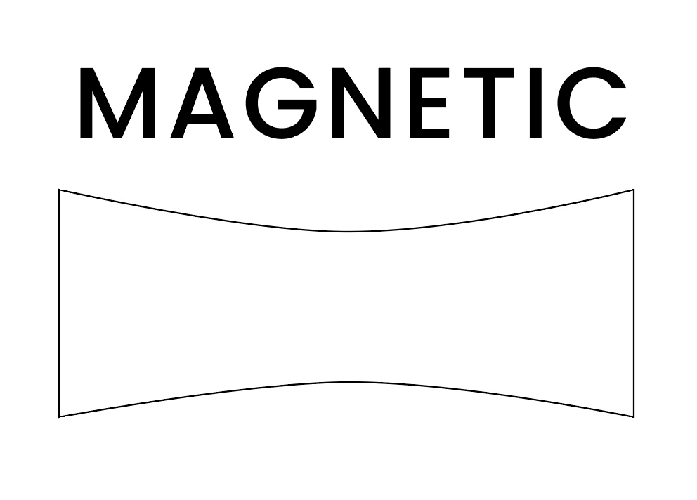

Becky,
If you are satisfied with this simple way, you can:
1) Write your word, you can keep it as live Type, then create a nofill/nostroke rectangle at least as large as the Bounding Box and apply Object>Path>Add Anchor Points, then centre align and Group;
2) Deselect, then Direct Select the rectangle and copy it to the front (Ctrl/Cmd+C+F+X+C), then move the middle Anchor Points at top and bottom towards each other to get the desired bow tie shape;
3) Select everything and Object>Envelope Distort>Make with Top Object.
Ctrl/Cmd+Z is your friends.
If you wish to stretch the outer letters instead, move the corner Anchor Points away from each other.
Edit: Images to show the way(s) all as live Type, the original in the middle:

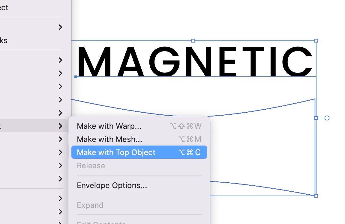

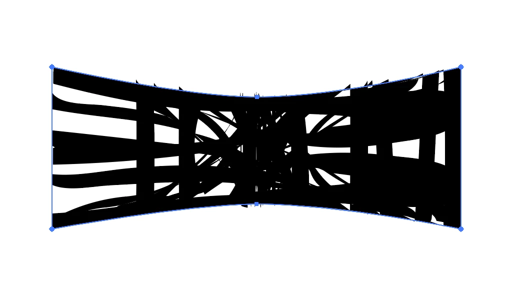

Prbolem is, when I try to envelope distort, this happens:
No matter if it's outlined or live text. So weird. The object was in front of the text too.

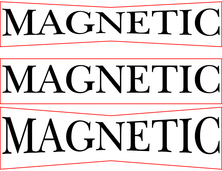

Becky,
You (still) have a curved shape at top and bottom.
My suggestion was based on a top object as a bow tie shape with straight segments, made by moving centre/corner Anchor Points up/down, see the screenshot below with the objects/frames shown in red, and it is important that you have corresponding Anchor Points on the rectangle grouped with the live Type in 1) and on the rectangle turned into a bow shape in 2).
What happens if you try that?
