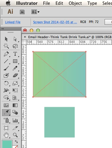

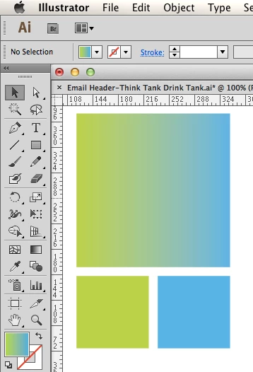

    I found a quick and dirty workaround to combining two colors to create a new color in Illustrator.
    1. Create a gradient of the two colors you want to blend
    2. Take a screenshot of the gradient
    3. Place that screenshot image in your working AI doc
    4. Using the eyedropper tool, select a color in the middle of the gradient until you find one that you like
    It’s by no means exact, but it’s super quick and easy.
    2. Select Object > Expand, specify the number of objects to expand the gradient to.
    3. While they are still selected, go to the Swatches Panel and select Add Selected Colours from the fly-out menu.
    You can then select them from the Swatches panel (and as a bonus they are Global colours).

    Hi Ton and Steve,
    Thank you both for the feedback. I apologize that I misunderstood the thread topic. I was looking for an easy way to create a new color from two blended colors and wanted to share my solution. I was creating graphics for an email and therefore only working in RGB/for the screen—I should have specified that.
    Ton, thanks for sharing your easier way!

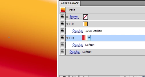

    I used attributes before tranparency blending modes. The appearance panel allows me to keep this all in one object for cleaner editing You can use multiply or darken with spots. I use darken instead of multiply, because our color laser proofs look more accurate – separations would be the same since the inks are spot.
    In the screenshot, am overlapping inks in the middle over the gradient with over 100% totol ink, so that the middle part does not look weak and washed out.
