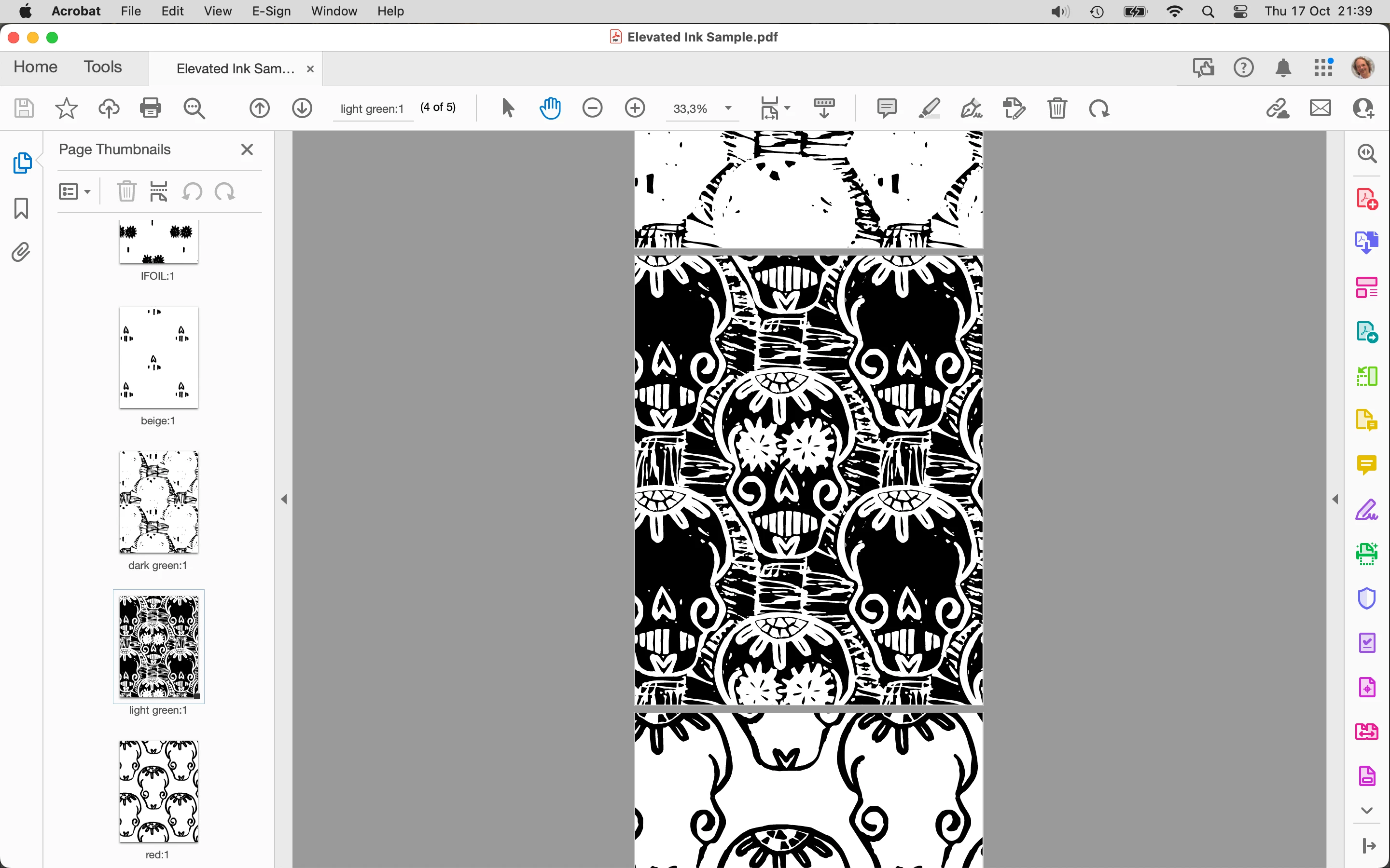

I am trying to create wrapping paper with elevated ink elements. I am starting with a pattern block, then filling the full size artboard with a fill of that pattern. I'm supposed to make an artboard for each spot color channel. I don't know how to separate the colors so that each artboard only has one of the colors. Or is that even what the directions are asking me to do???
I have attached a sample pdf showing the artwork. The elements in black are what should eventually be a gold  elevated ink.

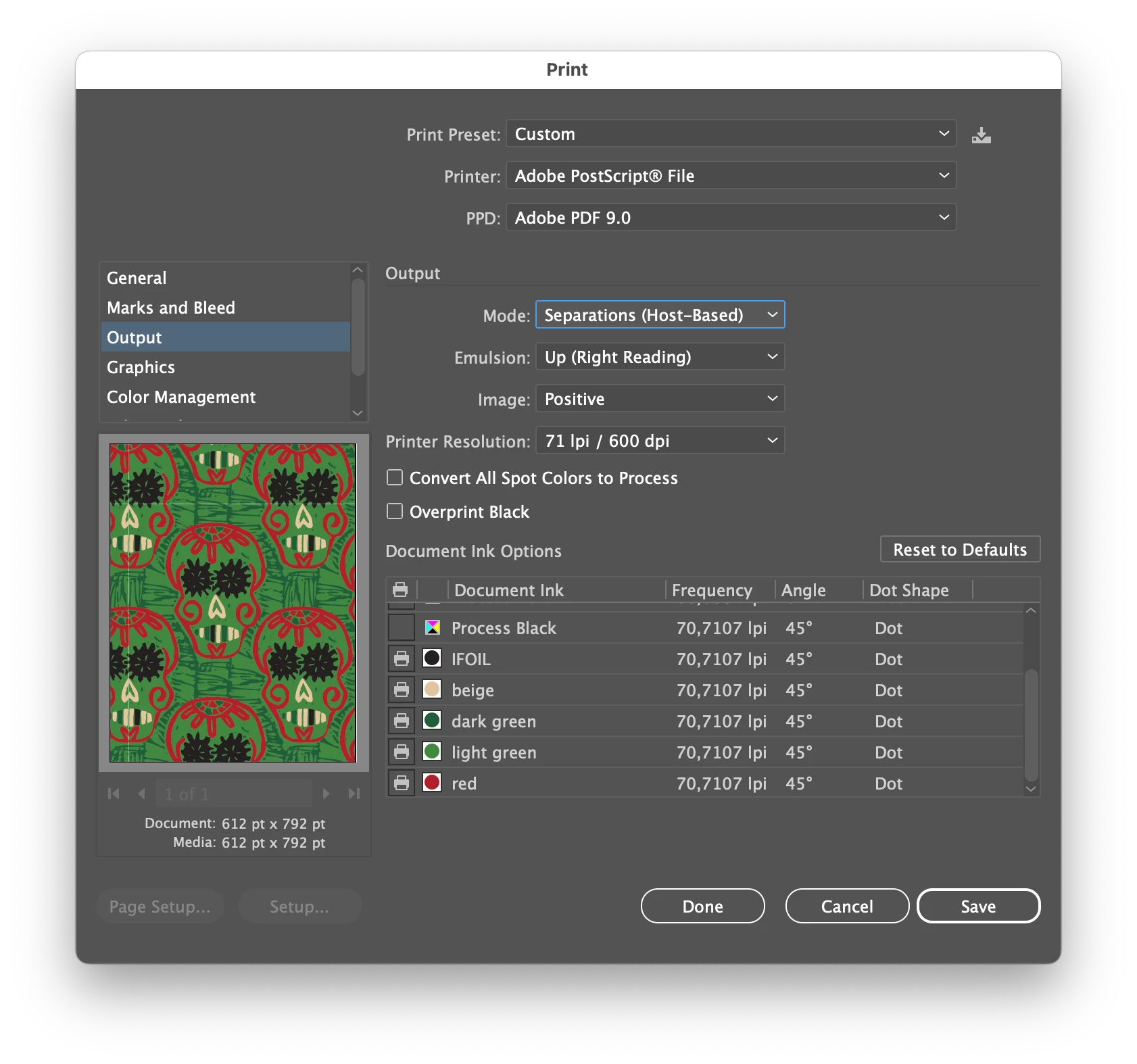

Another way to create separate plates for your artwork is to prints separations.
You can create separations by printing to a PostScript file and use the Distiller PPD
In the Illustrator Print dialog choose: Printer > Adobe PostScript File.
For PPD select: Other and choose the Distiller PPD: ADPDF9.PPD
Then you are able to select: Mode > Separations (Host Based) in the Output tab.
You can save the PostScript file and use the Acrobat Distiller to create the separated PDF.
But...
It will be a grayscale document that does not contain halftone dots, your printer needs to support printing halftone dots if you want to print anything else than flat solid colors.
The direct download for the PPD:
https://helpx.adobe.com/content/dam/kb/en/852/cpsid_85257/attachments/ADPDF9.zip

On that artboard your artwork doesn't tile.
Apart from that: as far as I understand that, you guessed corretly.
What you need to do: This cannot be a pattern, you have to expand the pattern.
Then release clipping masks
Select all and hit the Pathfinder Merge (it's in the second row in the panel)
Afterwards duplicate the artboard a couple of times and then in each artboard delete what you do not need.
