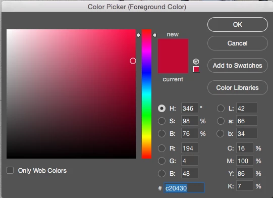

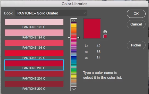

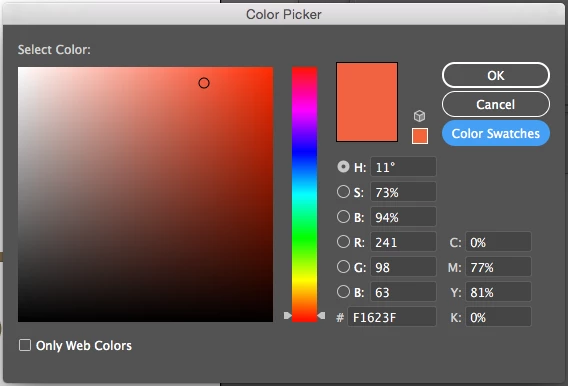

How can I view Pantone color libraries in Illustrator like I can in Photoshop? I use it to find the closest approximate Pantone color to a comic or rgb color. It would be really helpful to have this feature in Illustrator...
In Photoshop:
in Illustrator:

    If you wish to view the same Pantone color library in Illustrator that you have shown in your Photoshop screen shot, you could open the Swatches panel in Illustrator.
    • In the bottom left corner of the Swatches panel is a panel button labelled "Swatch Libraries".
    • When you click that button a flyout menu appears.
    • If you choose "Color Books", then you can choose the same library (such as Pantone+ Coated in your screenshot) from the submenu that appears.
    • Once that library opens, I recommend clicking the panel options flyout menu button (in the upper right corner of the library) and changing to one of the list views so that more information is displayed for each color.
    The colors are displayed as swatch libraries and appear in a different fashion than you see them in Photoshop but you should be able to make the transition.
    Hope that helps. :-)

    It is different in Illustrator.
    When you have selected an object with a color you can find the nearest Pantone color with Edit > Edit Colors > Recolor Artwork
    Choose a 1 color job and the Pantone Library.

    Use Edit > Edit colors > Recolor artwork to convert any selected vector artwork into a chosen Pantone color space. Make sure color management is set up accordingly.
    Or set the color guide panel to a Pantone library and then select a color in the colors or swatches panel.

    That's if you have a printed sample to match. More often than not, you're starting with an RGB or CMYK file and no printed sample, in which case starting with the Photoshop method, combined with the swatch books and a bit of instinct, is your best shot at finding the most appropriate spot ink.
    It would definitely be nice to be able to do the same in Illustrator, but the Recolor Artwork method works.
