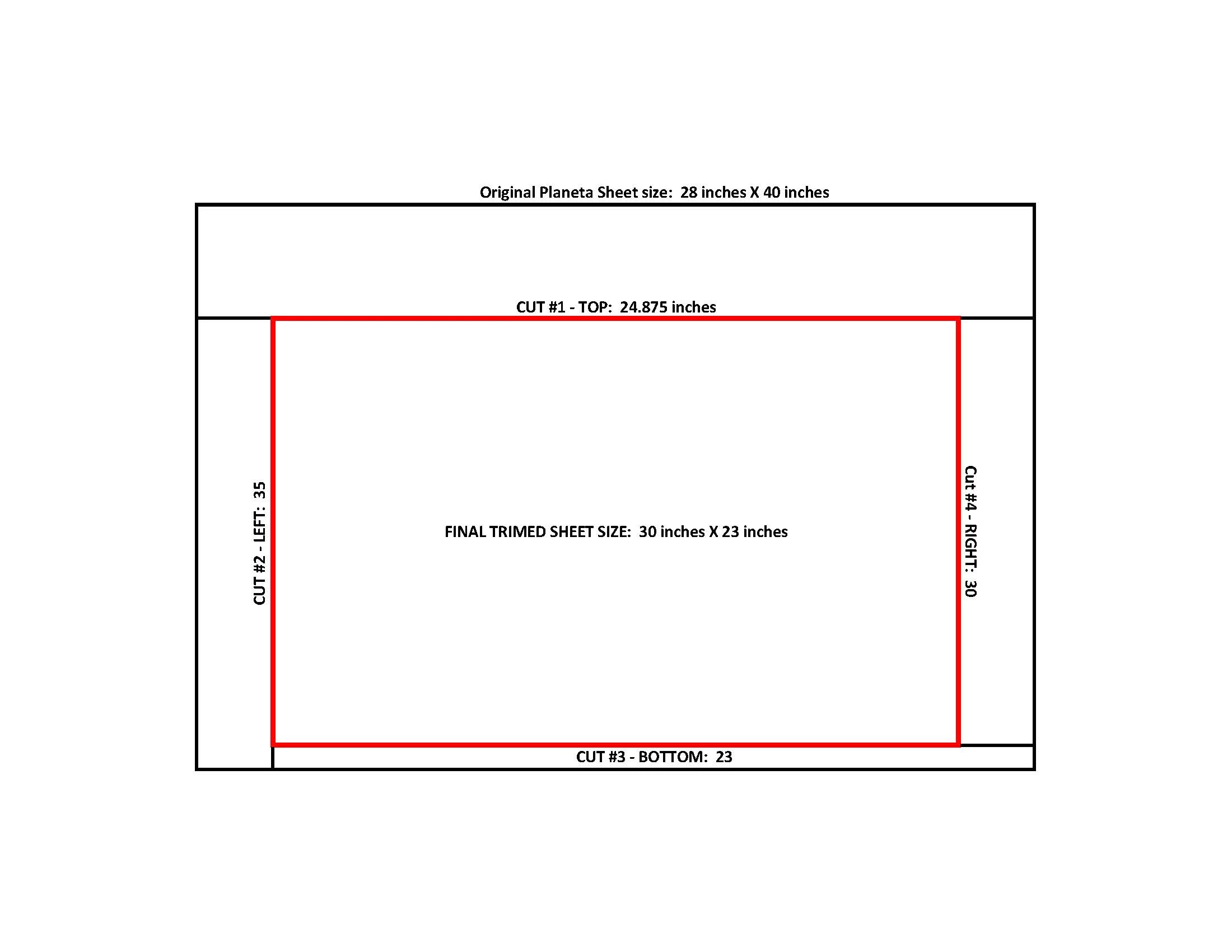

Our example would be a 28" x 40" press sheet that needs to be trimmed down to 30" x 23"
The numbers we need to generate are:
24.875  (Cut from bottom to top to maintain the press lead edge, which is at the bottom of the sheet)
35 (Cut from left to right)
23 (Cut from top to bottom)
30 (Cut from right to left)

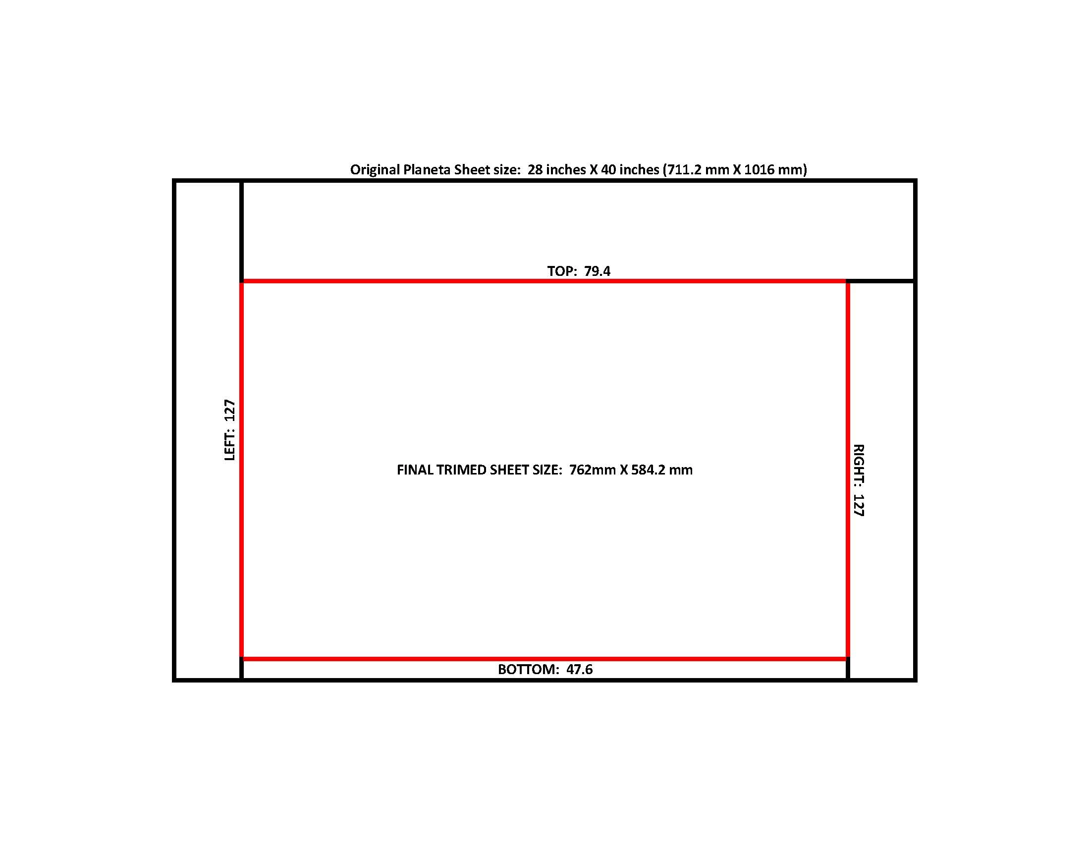

Here is a visual of what we are doing:
The object we would be selecting in the Illustrator file would be a box that is 30' wide and 23' tall, and the 0,0 point of the file would be moved to the lower left of the larger box (the original 28" x 40" press sheet) before this that selection was made and the the script is run.

In a perfect world, the final output would look like the image below, but a simple listing of the numbers will get me to where I need to be.
