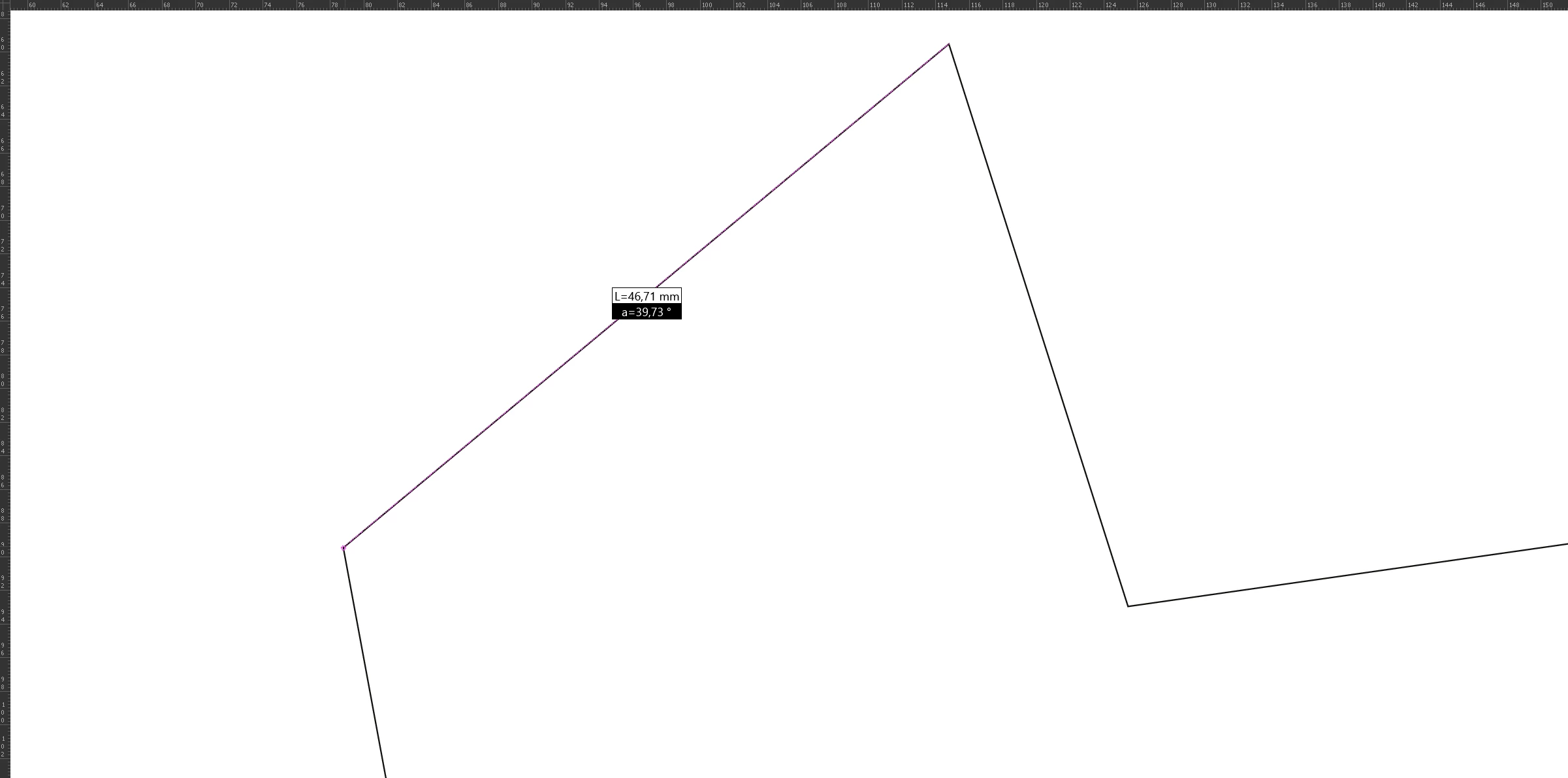

You may also use Illustrator's highly acclaimed Measure tool together with the Info palette to display angles.
The Measure tool is snap-sensitive and it can be precise. You may just not notice it at first glance and some dexterity is certainly required.

JLG Lines always measures from the horizontal line

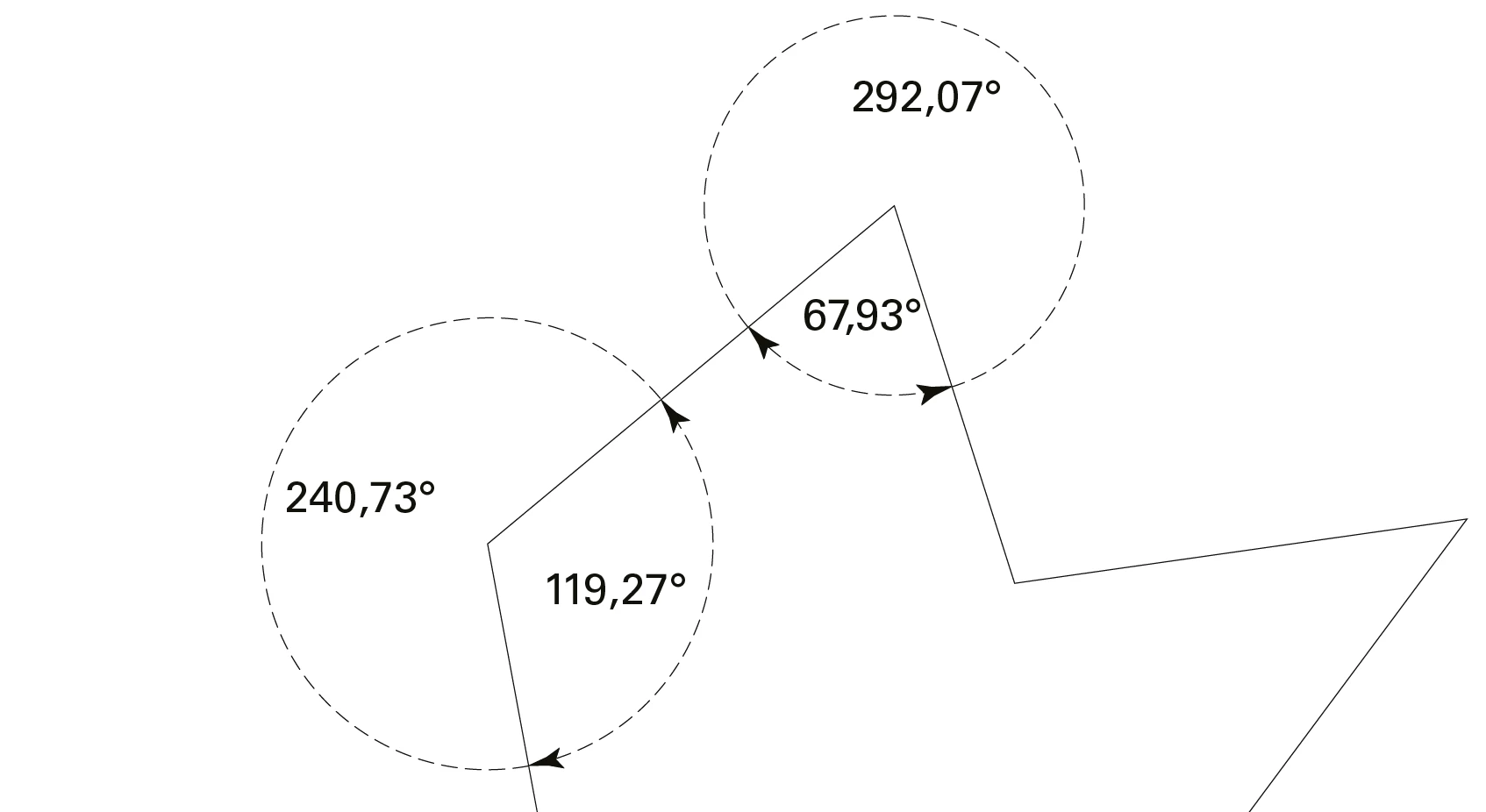

Yes, unfortunately this is still not possible with Adobe Illustrator after many years. You must use a tool. FOR EXAMPLE. JLG Dimensions or JLG Lines

Thank you for taking the time to create the diagram!
I bet you excelled in Geometry Class!
