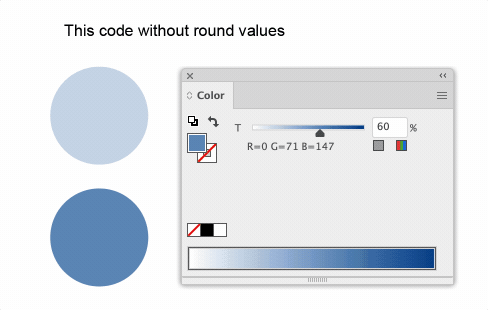

I once needed to parse color values from a spot tint. As I understand it, it uses linear interpolation from white to the original color. I wrote a note about this with a code example: https://aiscripts.medium.com/get-spotcolor-tint-color-b699f569c03d
