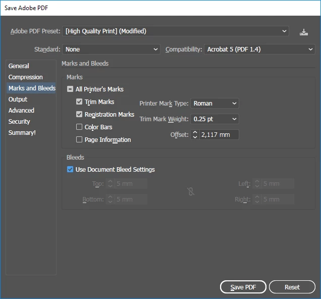

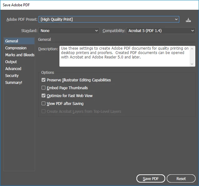

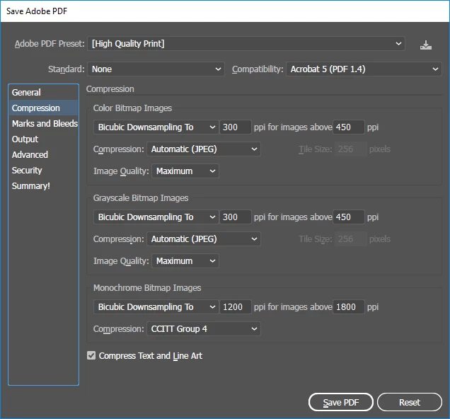

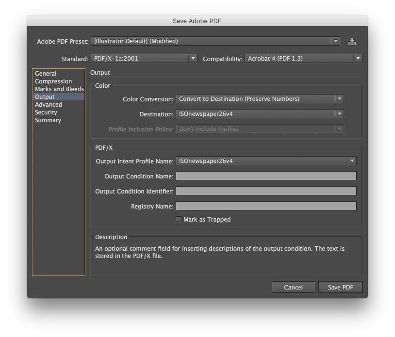

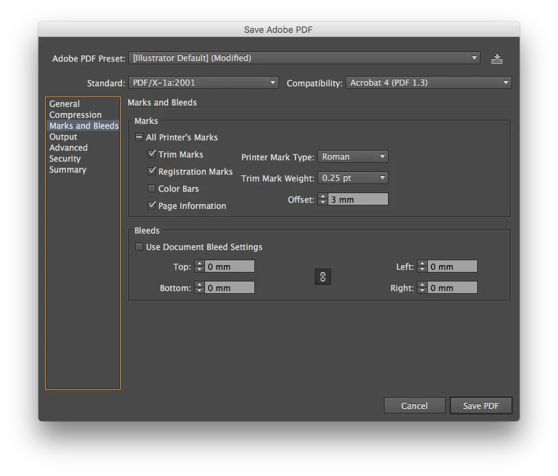

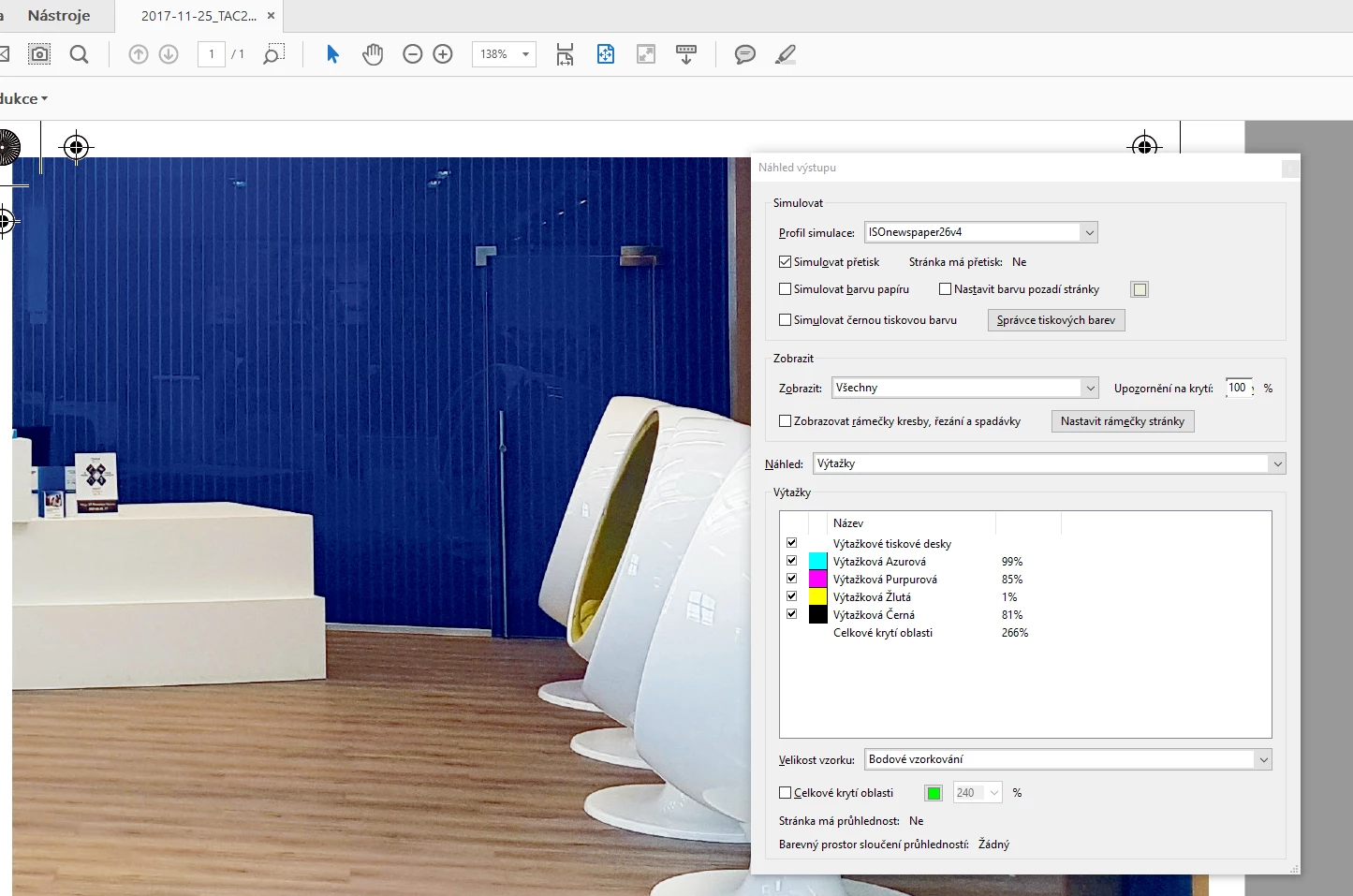

Here is AI + PDF:
https://drive.google.com/file/d/1sWCdn3je6omkMjx8Q1Hz1DdPE_OVFdV2/view?usp=sharing
Below screens:

Can you also provide the setting in Acrobat's Output Preview?
You need to select the correct profile there. Otherwise it might read the wrong values.
