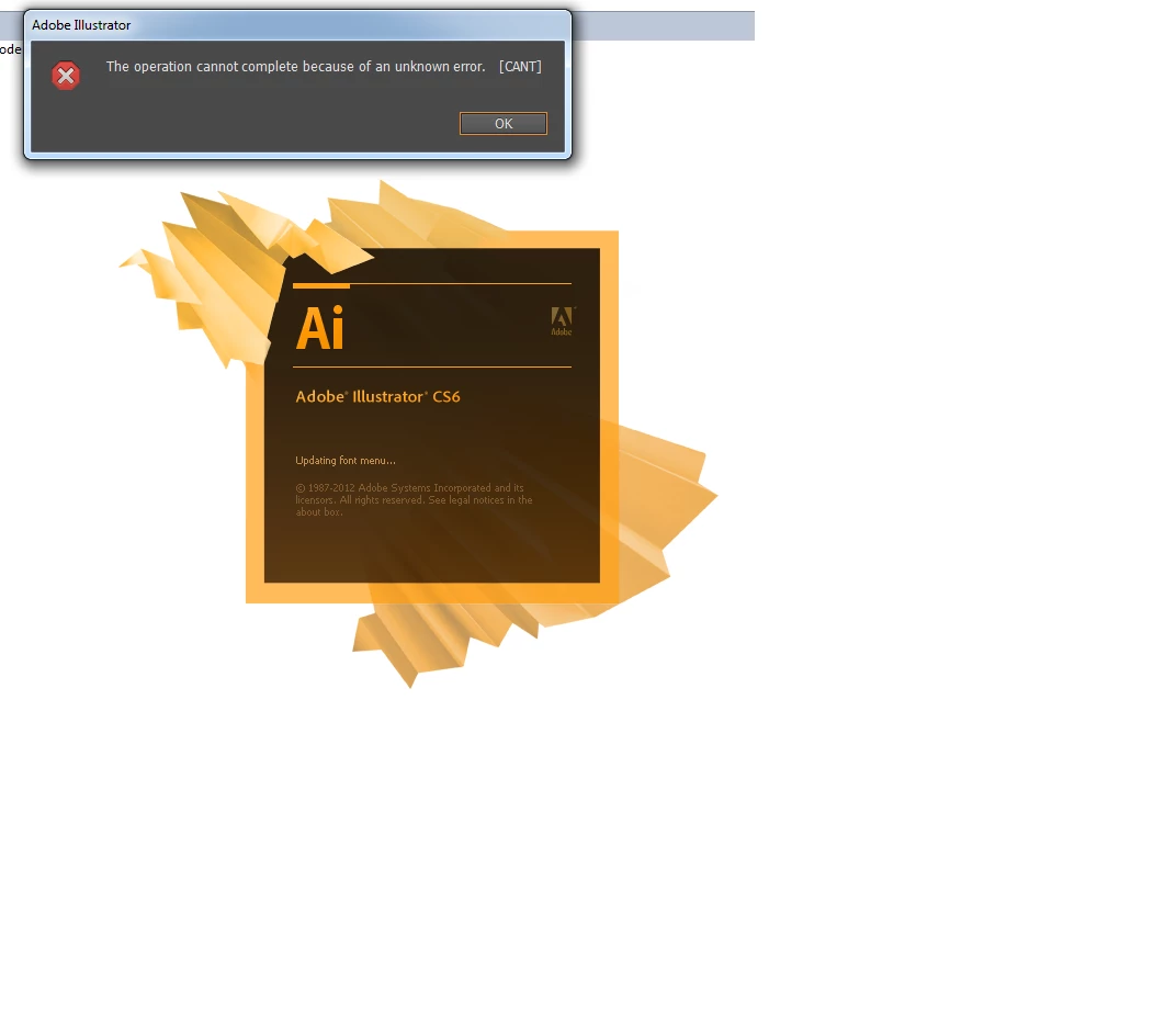

When I wrote a code for Tool Plugin It's gives a message like this
How I will resolve it .,Please assist me.
Regards
Kundan

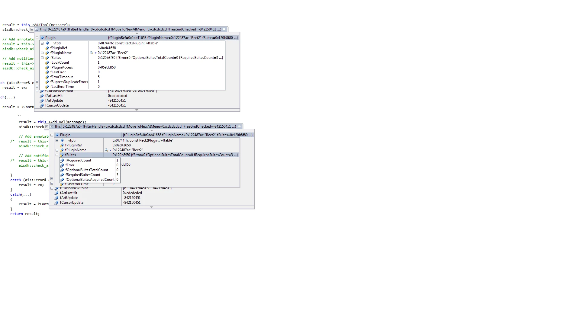

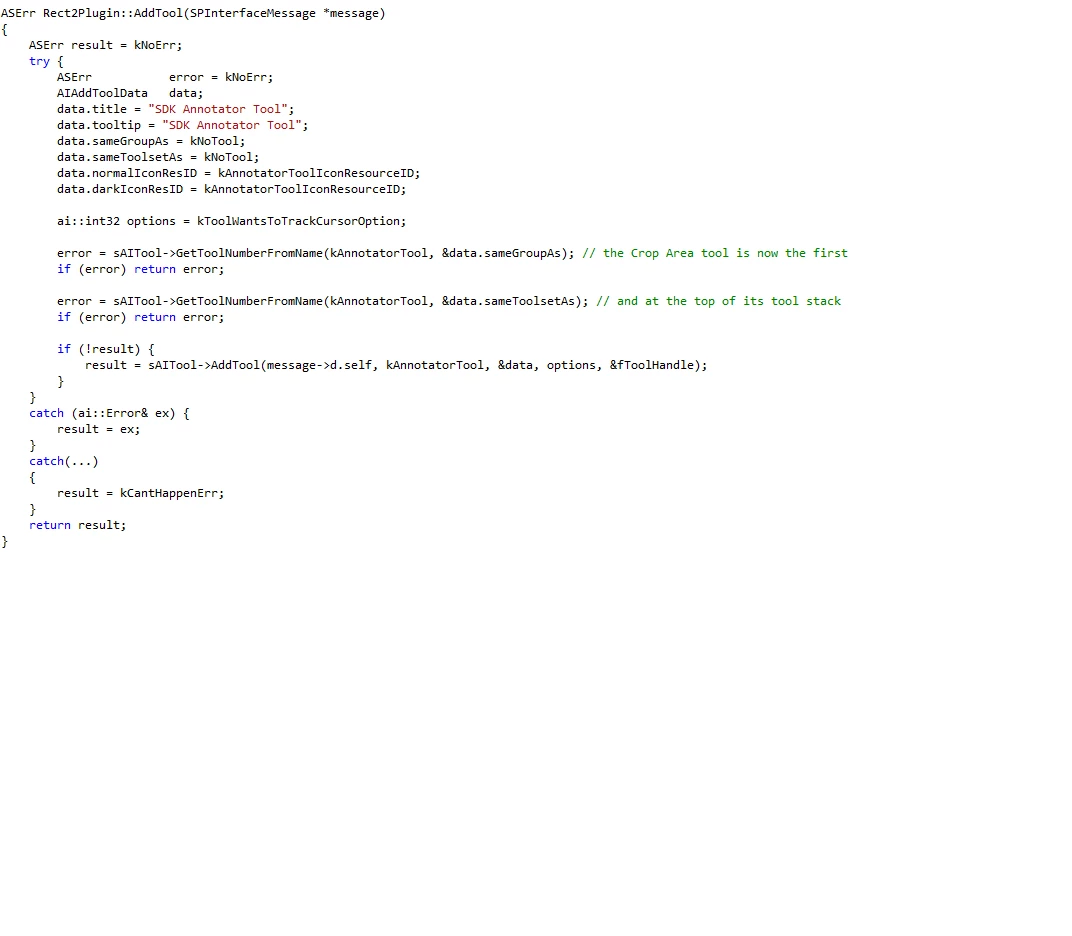

May 11, 2016
I am adding a Tool Plugin by using  this code
It's  the sample code  of Annotrator I  using this code inside  my project .
After calling Add tool  function inside  StartupPlugin ,It's  build successfully but when launching the
Illustrator CS6 It gives the error shown in 1st discussion .

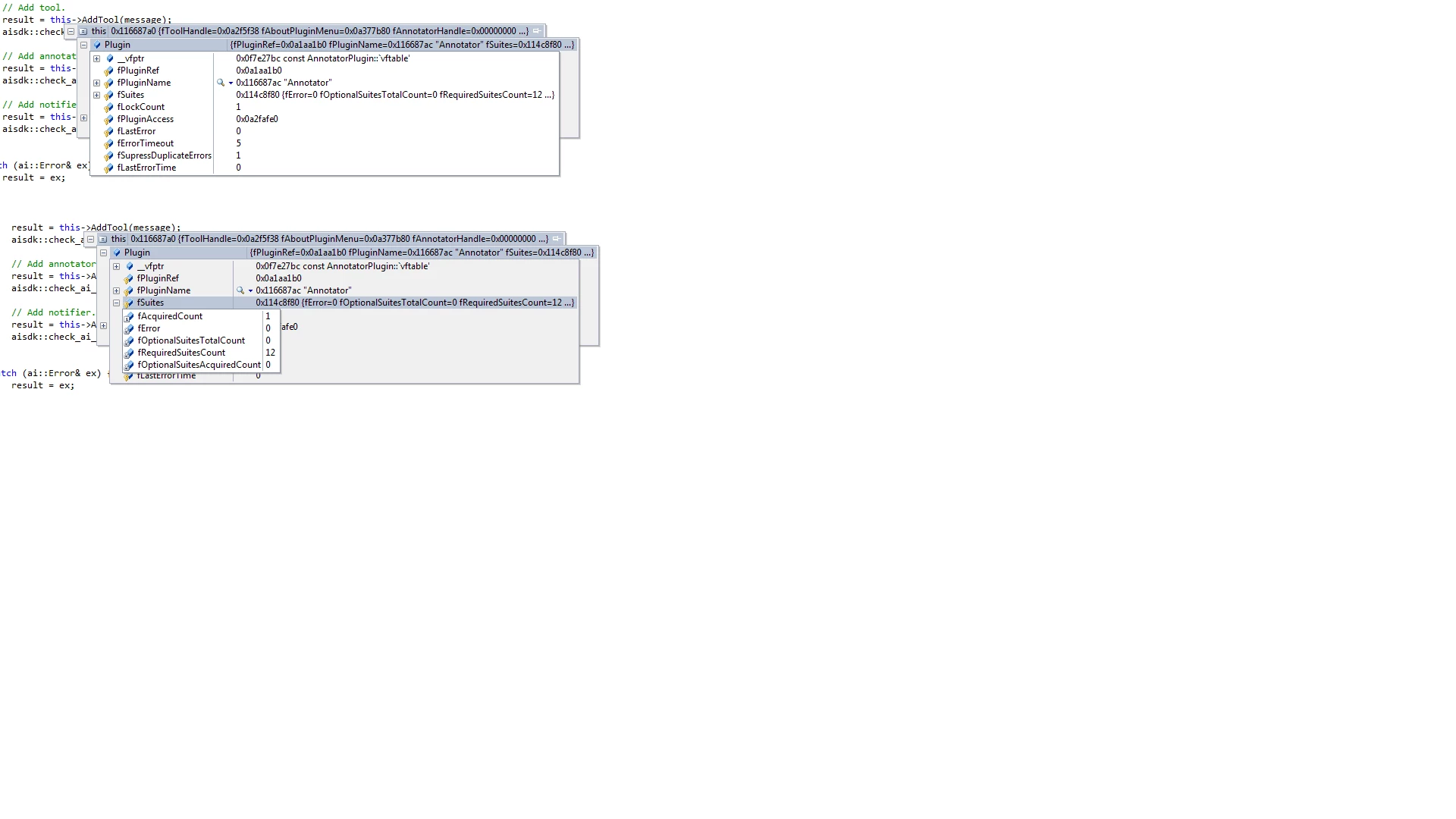

I debug both  Annotrator and myproject also.
After debugging Annotrator code I got this result
After debugging my project I got this result
This is the scenario.
so Please assist me.

May 11, 2016
You need to step through Rect2Plugin::AddTool in the debugger to find where the error occurs. My guess is that sAITool is NULL because you haven't added the tool suite correctly.
