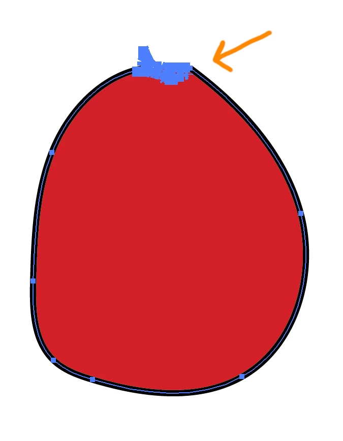

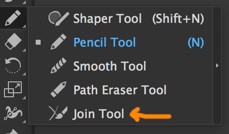

Yup. Selecting "fill paths" should help, and if you find that your ends aren't joined up you can also use the join tool, which is hidden under the pencil tool.
Simply choose it, draw over the gap, and you'll have a closed shape.

In order to fill shapes drawn with the pencil, the entire path has to be closed (ends connected). The easiest way to accomplish this is to use the Direct Select Tool (white arrow) to select the 2 end points (select one, then use the shift key to select the other) OR, you can use the selection lasso to lasso the end points. When you have them selected, go to the Object Menu>Path>Join, or use control (or command on Mac) +J. When the ends are closed, the interior can be filled.
