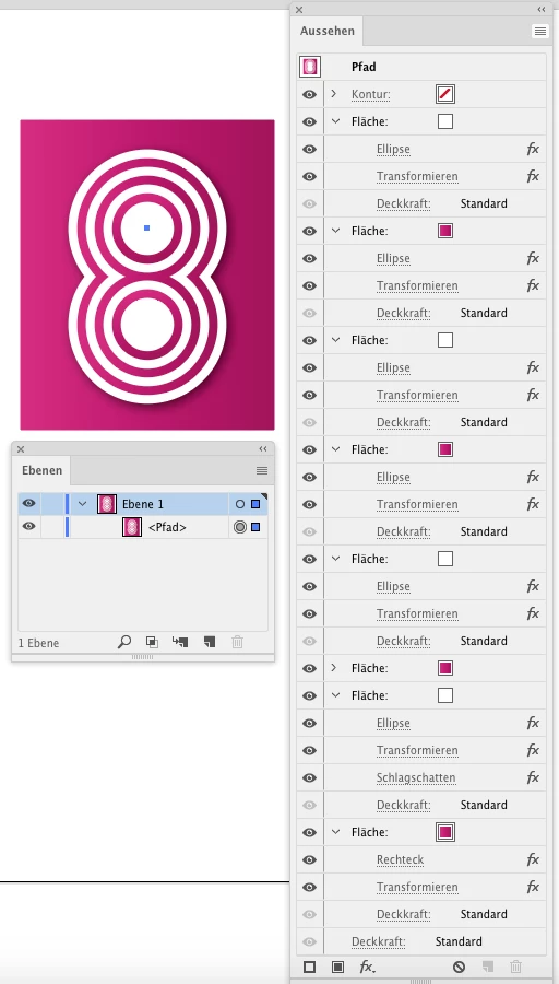

All of those copies of the object are compeltely unecessary. Multiple strokes can be added to a single object using the Appearance pallet.

Monika Gause
February 3, 2020
Guy uses too many shapes in that example. An anchor point would be fully sufficient 🙂

To add multiple outlines to one shape use the Appearance panel.  https://helpx.adobe.com/illustrator/using/appearance-attributes.html
You can add multiple outlines, multiple fills and/or effects to any or all of these. Note that some effects will need rasterisation and the artwork can uickly become very complex. By expanding appearance you can then split the creatied shapes into simpler components if you need to tweak them. (This is a video of @Monica Gause creating artwork just using one point and the appearance pannel… just to inspire you with the potential https://vimeo.com/20576596)
