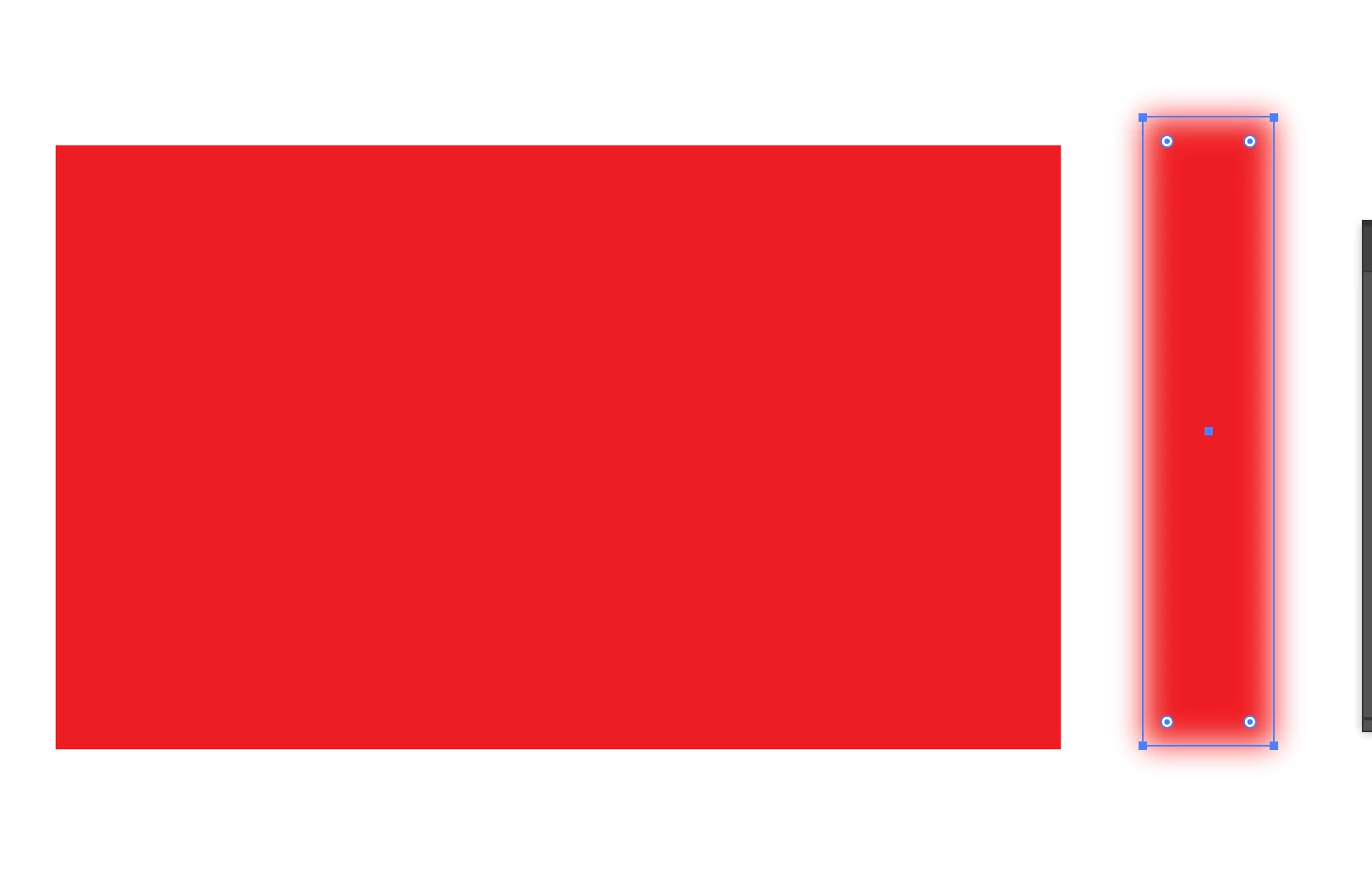

As far I know, blurs apply to the entire object. A good work around would be something like this.
Make your object and then copy the the part that you want to apply the blur to:
Then apply a clipping mask so that only the side you want is visible:
The result I think is what you are interested in:
You can also just copy the path of the side that you want and apply the blur - but it wasn't shoeing up well for demo purposes. Hope that helps.
