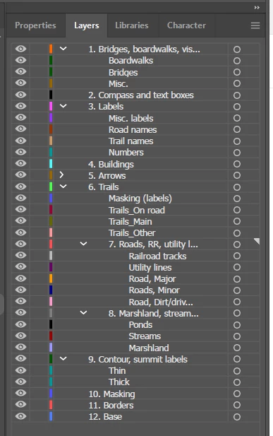

I'm trying to do something that I would think would be very simple, but I've walked a couple of videos now and have scoured the forum and have come up empty-handed. How can I change a sublayer to a layer and then have it in the correct order? Here's a screenshot:
I'm trying to get layer 8. Marshland so that it will be under layer 7. Roads but not nested under 7. Roads. I would think that would be really easy to do, but I've spend half an hour so far, fruitlessly dragging it, using Ctrl and Shift and various combinations, but so far I can only do one of two things:
a. Move 8. Marshland to the very top of the list, above 1.
b. Make 8. Marshland a sublayer of 7. Roads.
What am I missing? I hope I don't need to install a script or something like that for what seems like such a basic thing to do. Thanks in advance!

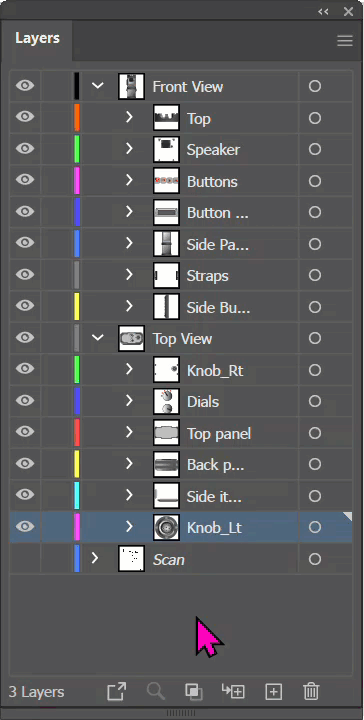

I tried to come up with a demo situation equivalent to yours. Here I want to move Layer3 from a sublayer to a main layer below Layer2:

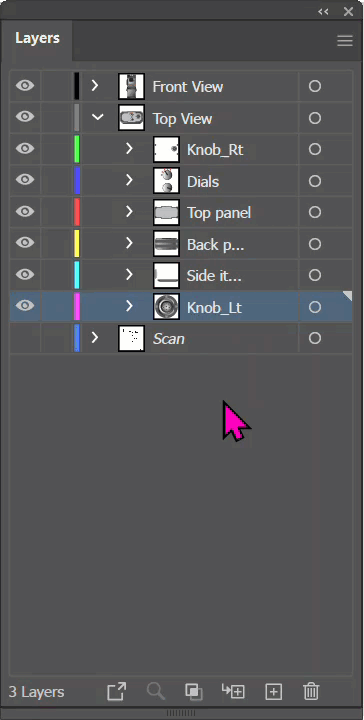

As you said, I can only drag it somewhere away from Layer2, so I drag it to the top for simplicity. At this point, if I try and drag it to the correct position, it just becomes a sublayer of 2 again -- but not of any other layer. So I drag Layer2 out of position, in this example to the bottom:
After that, I can drag Layer3 in between Layer1 and Layer4, then drag Layer2 above it. Now I have the correct order:

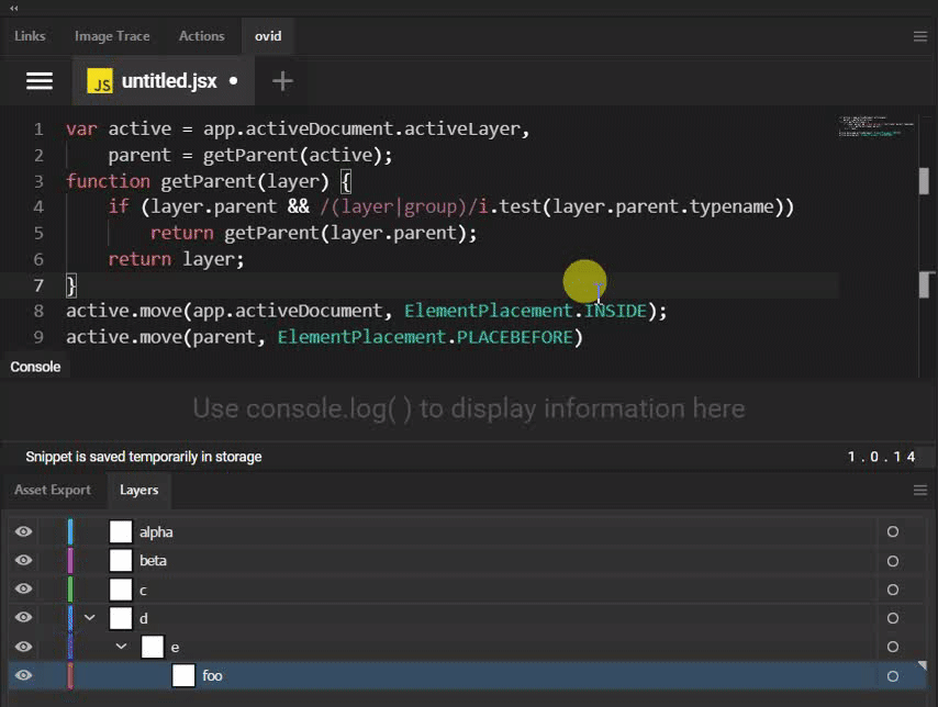

Very easy to solve with a basic script:
var active = app.activeDocument.activeLayer,
    parent = getParent(active);
function getParent(layer) {
    if (layer.parent && /(layer|group)/i.test(layer.parent.typename))
        return getParent(layer.parent);
    return layer;
active.move(app.activeDocument, ElementPlacement.INSIDE);
active.move(parent, ElementPlacement.PLACEBEFORE); // PLACEAFTER if wanting it to be below parent
That way you could use Insert Menu Item within an Action and assign to a hotkey if needed, though looking at the document it'd be far better to parse through all layers and sublayers then separate any with a "\d*\.\s" prefix and automatically sort/order them at the root of the document instead of ever needing to do any manual dragging.

Certainly seems odd. I can (initially at least) drag a sublayer to any position except below the layer it came from -- if I do that, it becomes a sublayer again.
What I can do to get around this: Drag the sublayer to the top of the list (or anywhere else), drag layer 7 to another position (the bottom perhaps), drag the sublayer to the correct position, then drag layer 7 back into the correct order.
December 10, 2021
Hi Doug,
Thanks for the quick reply! Alas, I tried those instructions, but that left me with this, where 7 and 8 are now sublayers of 9:
Any other ideas out there? Thanks!
-- Bill
December 10, 2021
Oops, apologies for all the typos this morning: they're now sublayers of 6, not 9.
