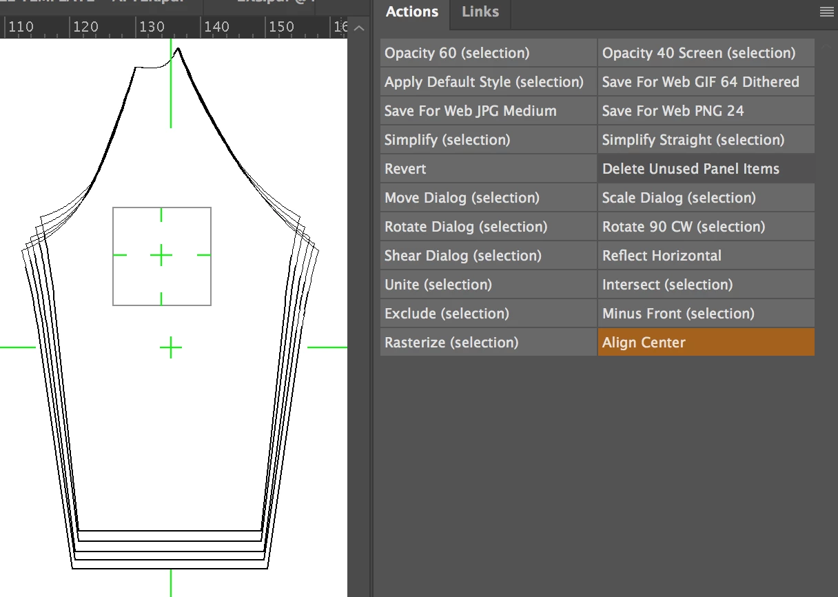

if all you need is running actions, you don't need a script.
Use Actions in Button Mode
