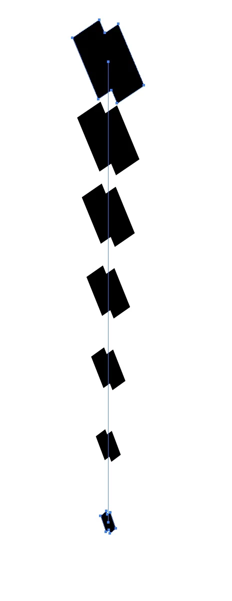

as a simpler manual option you could just draw the shape at the top, then scale and adjust one at the bottom and use a shape blend to make one 'column' of the pattern, then repeat it across the page.

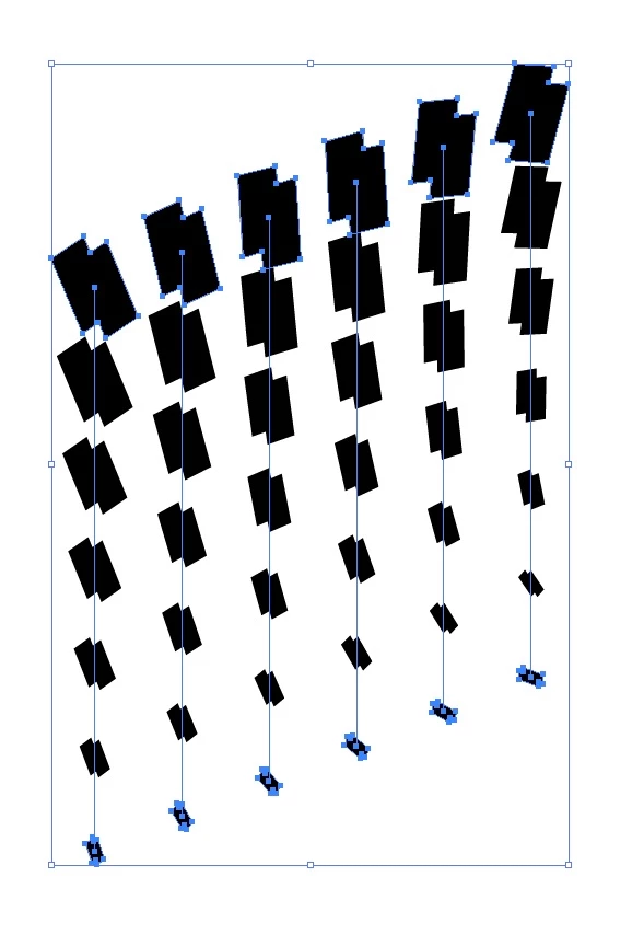

July 25, 2016
you could modify the arrangement of blend shapes to get a continuous change to shown here, by rotating the top shape a few degrees each time, and the bottom one a few degrees opposite.
