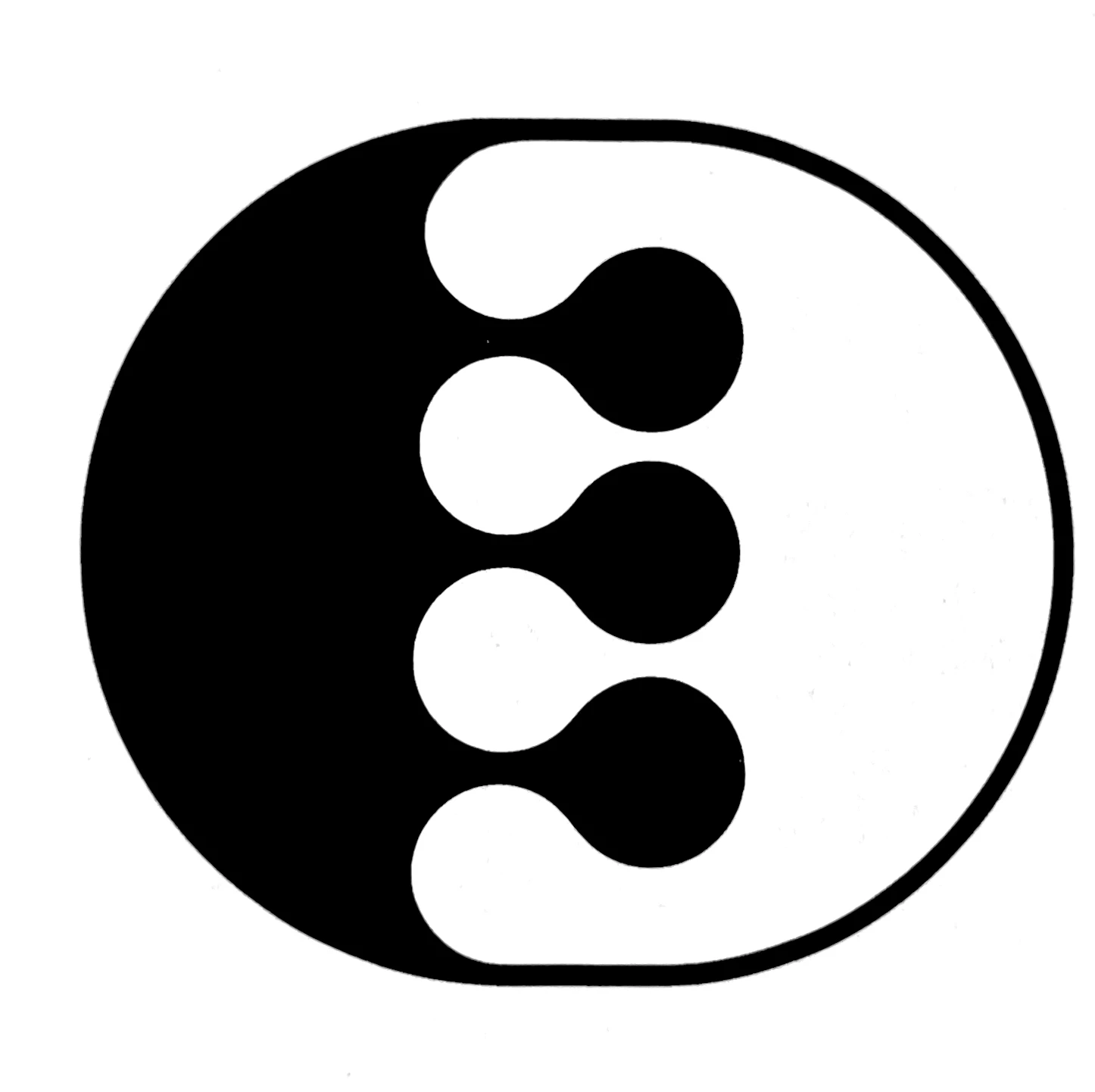

how to create a rounded ribbon-zipper line like this ...?
  • July 31, 2023
  • 1421 views
Hi there — stumped as to how to create this lovely mirrored line — original logo 1967 (Peter Megert) — any tips much appreciated! Im thinking I might need to connect circles at their tangents...

You're right. I can't get it to work either. It should work, but it doesn't.
What will work though is when you use a helpter object and unite the shapes. Draw a rectangle around it. What's important: the top circle doesn't kiss the second one. You have to check the gap detection in the options.
https://youtu.be/ev0jIZHy57w
Monika Gause
July 31, 2023
If you put circles into it, then you see a couple of things:
The black circle is larger
The circles do not meet perfectly, but it was adjusted.
So I would start with circles, then cut them and stick the parts together.
Build just the part bwtween the 2 green lines. Then reflect to build the rest.
Snapping circles or any curves precise together in Illustrator is a pain in the rear. The plugin Colliderscribe is a great help, but comes at a cost.

thanks Monica... I use Astute graphics for their halftone tool, so I think I have ColliderScribe — will try it 🙂
Monika Gause
July 31, 2023
Then of course you have ColliderScribe. Lucky you!
https://youtu.be/EoRQagiRUzU
