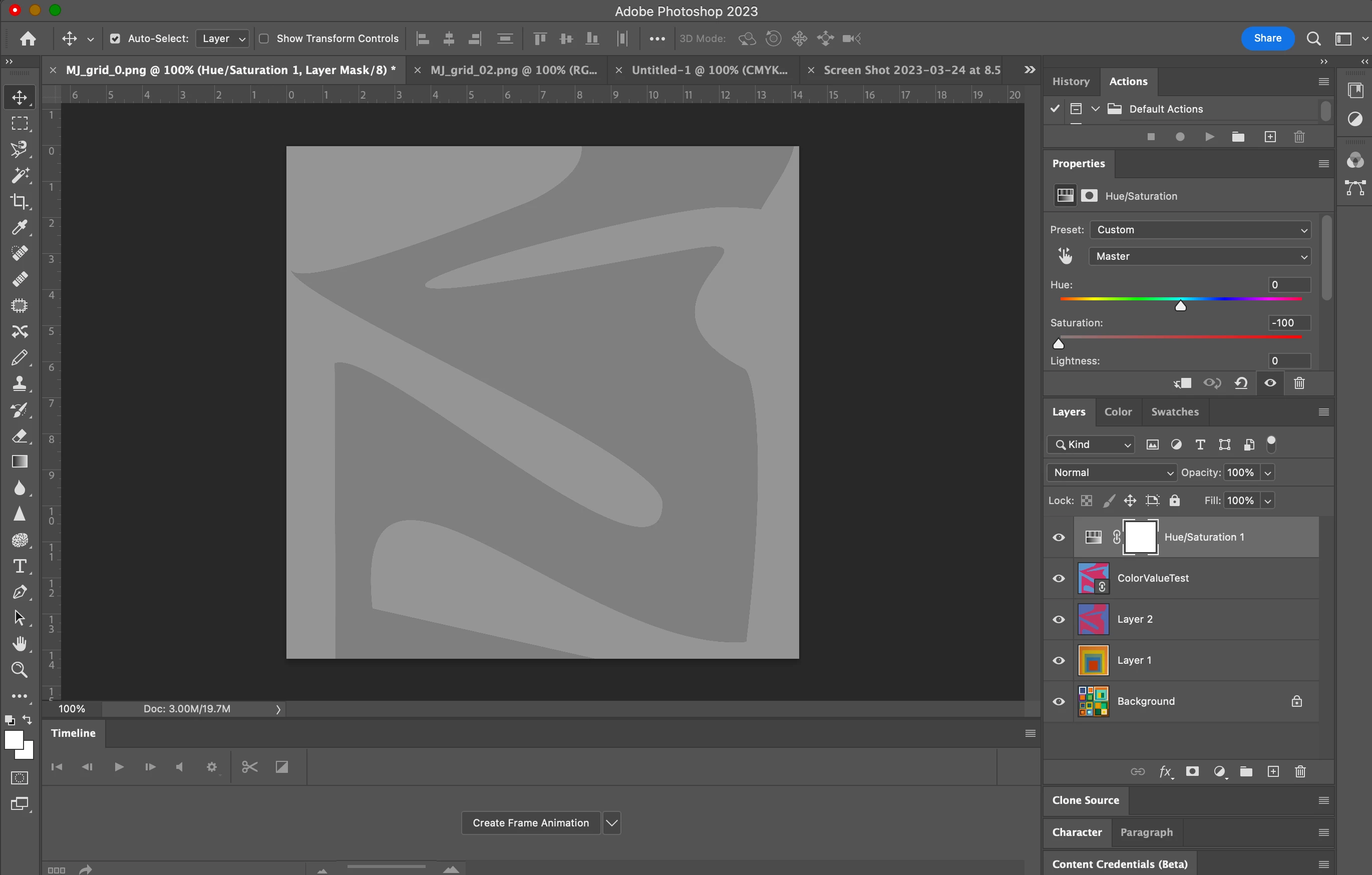

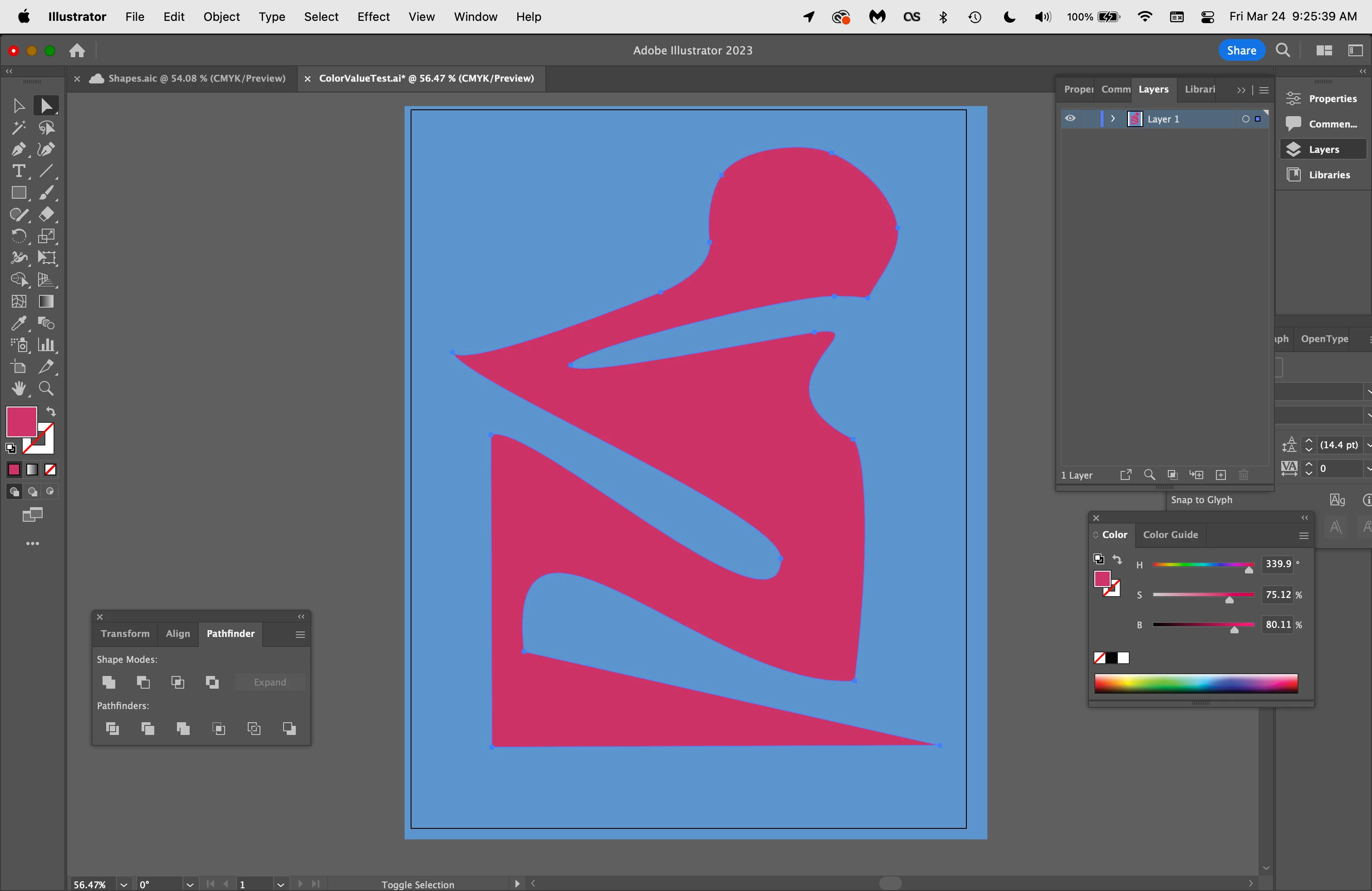

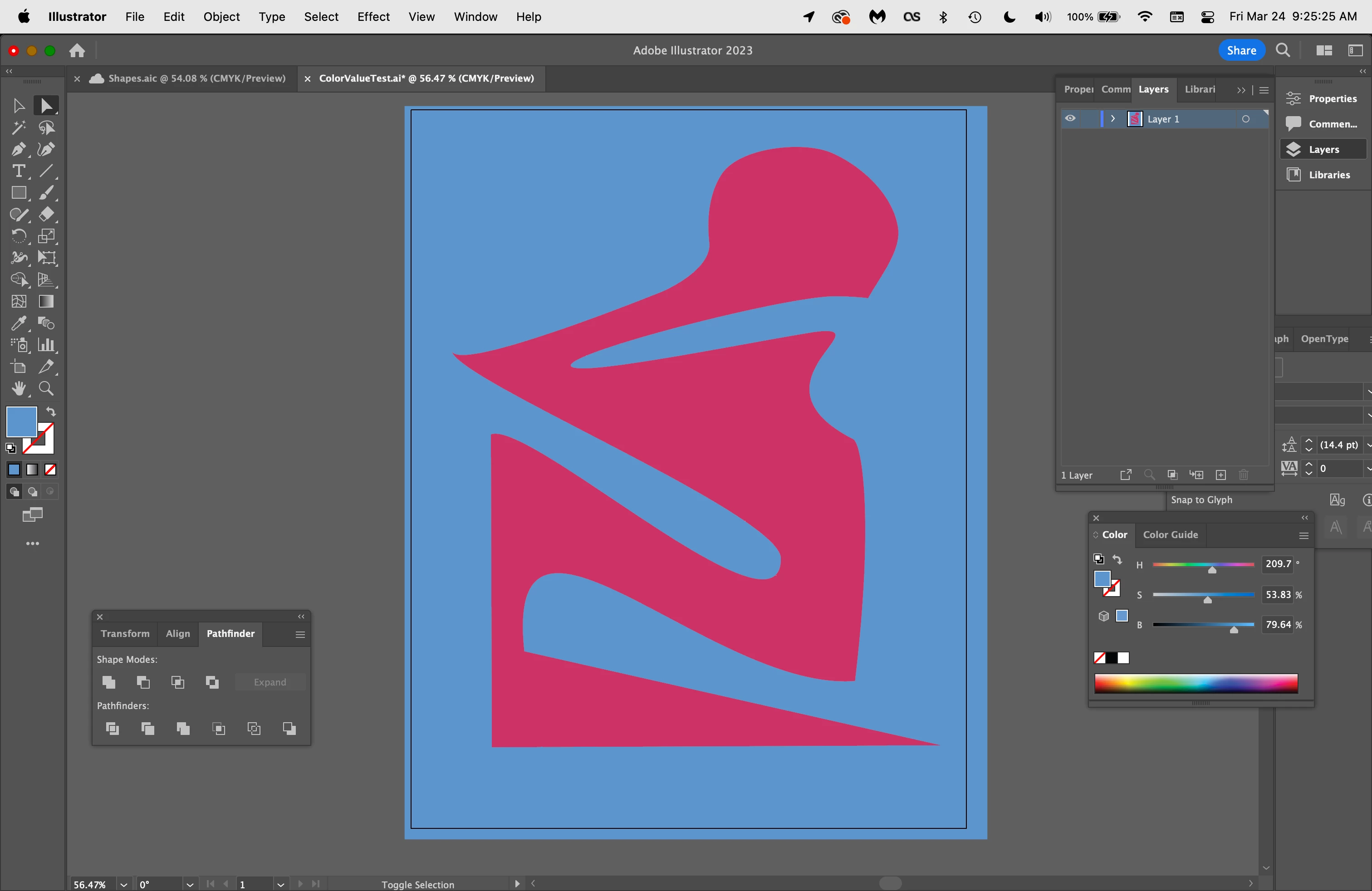

I think this should be simple.  Using the HSB color tab, I'm trying to create colored shapes of the same VALUE such that when I desaturate the image as a whole, the shapes disappear.  But when I use the tab, and Place the image in Photoshop with a Hue and Saturation Adjustment Layer and set Saturation to zero, removing the color information, the shapes remain distinct.
I think I must be fundamentally confused about the interaction of these three variables: Chroma/Saturation must add to Value, thus these aren't independent variables.
So, is there a way in Illustrator of achieving my goal?  Thanks.

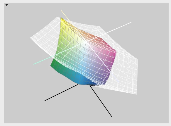

When defining your colors in HSB you are using a very large color space. In an RGB ocument those colors are preserved. In a CMYK document they get converted to CMYK the moment you lift your finger from the mouse button. This is a CMYK color space inside an RGB color space. There might be slight deifferences between this plot and the specific color spaces you are using, but basically this is it:
So you are difining something outside of the small space, it will automatically be moved to the inside and of course changed.

I finally got it to work, and yes, both docs, in Photoshop and Illustrator are set to RGB.  You're right, when in Illustrator the Document Color Mode was set to CMYK, using the HSB sliders wouldn't stick.  But I do need to learn more about color, particularly about how the warnings work (Out of Web Color Warning and Out of Gamut Warning)
The solution, which is imperfect, I think because of antialiasing, requires that the Brightness AND Saturation be equal, letting the Hue be the only variable.  Which is interesting, because I thought these three would be independent variables, but Saturation and Brightness both affect to Value.  Not sure why.
If you look at the gray png you can see the contours of the shapes.  Which means that the antialiasing must be adding brightness or contrast, just a little.  I see tutorials online for turning this off, so I'll have a look at these.
