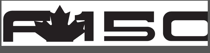

I have found several responses that are close to what I need to do, but not exactly applicable to my specific need.

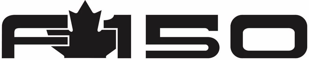

I'am trying to create a negative space between 2 objects. I was able to achieve what I wanted to do via a white stroke in the first image (I know I accidentally cropped out part of it on both), but that didn't change the outline view which I need to be reflective of what I was trying to create. The second picture is what I have to work with. Thank you for help with what seems to be pretty basic of a task.
    Correct answer mattheww53222436
    Actually once I was able to expand the live paint there where some new cut lines and I just manually deleted all points needed to create the space. Thank you!

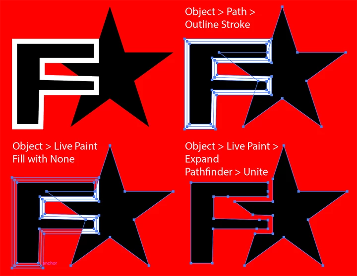

    You can try: Object > Path > Outline Stroke
    Object > Live Paint > Make
    Use the Live Paint Paint Bucket to fill the white areas with None
    Expand the Live Paint group
    Use Pathfinder panel Unite to unite the black area.
    November 22, 2017
    Everything worked good until the expand live paint. It deleted the now transparent stroke layer and there is nothing to Unite anymore.
    mattheww53222436AuthorCorrect answer
    November 22, 2017

    November 22, 2017
    Yeah it's hard to explain. So the type is already an object and borrowed from a logo website. The file will be used to cut vinyl decals. When I had it just with the stroke outlined and white (to match the background) the lines were still behind the image in outline mode. That translates to cut lines with a vinyl cutter and thus ruins the whole decal. I was trying a remove from back/front approach, but couldn't get it to just remove the stroke object from the leaf.
